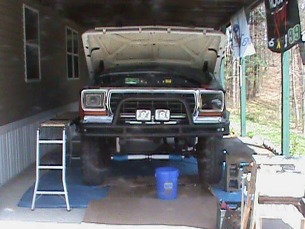

In my Garage

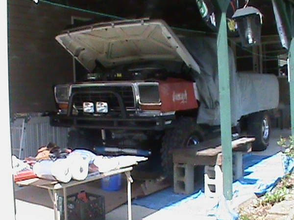

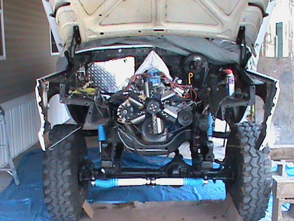

preperation is key...tarps and lots of cardboard to respect the Landlords property.... access planks fender covers. the truck cover will hide parts in the bed that are removed from the vehicle keeping eye sores at a minimum along with saftey
Teardown of the grille radiator support is eccential to gain easy access to the engine on a lfted vehicle for the heads will be pulled first..I already know the bottom end of the motor has no issues....we will concentrate on headwork along with cam and lifters......Lights Out!!
the goal here is to spend as little as possible,but gain some low to mid range torque/Hp along with just maybe a few mpgs as well....stay tuned! :)

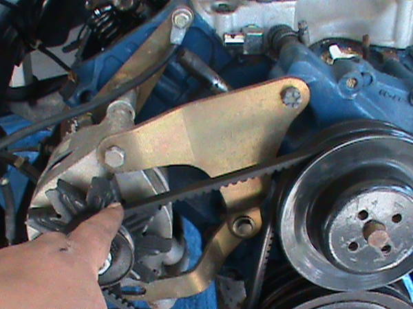

remove alternator / assembly...vwiiiiiiit vwiiiiit

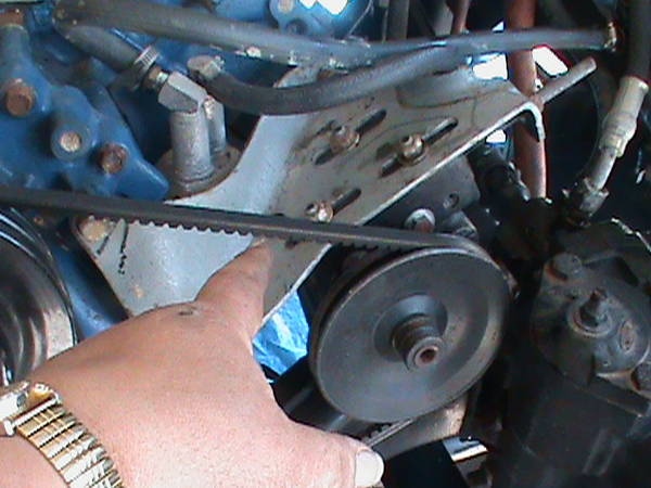

remove P/S assembly.....vwiiiiit vwiiiit

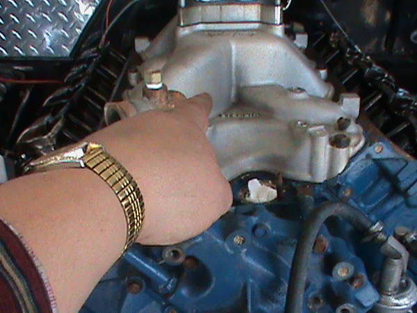

remove Intake.....vwiiiit vwiiiit x # of bolts Gently pry up to loosen once bolts are removed...with a prybar.

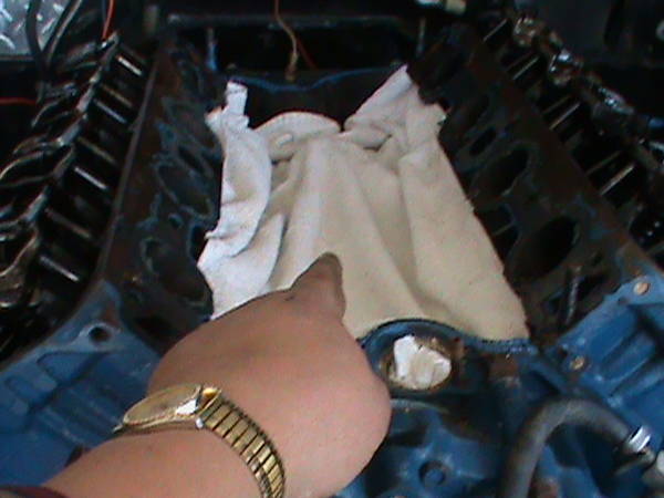

once the intake is removed...keep the valley covered to keep out debris...

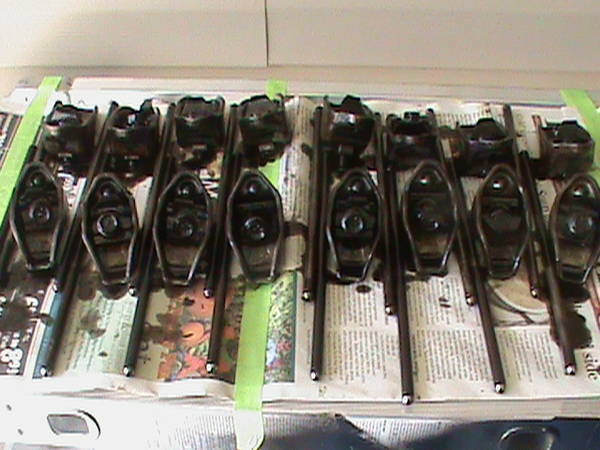

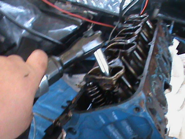

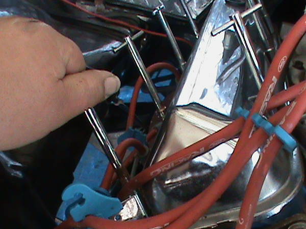

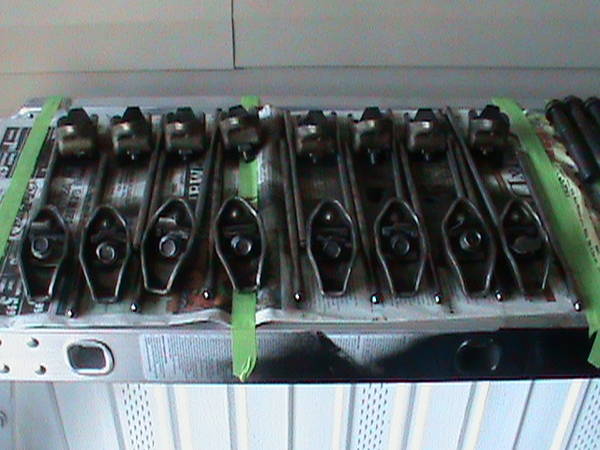

loosen & remove all rocker arms/pushrods....Keep them in order in their relation to one another along with each cylinder location..you do not want to mix them when reusing.
Layout of rockers and pushrodsin according to relation..top row passenger side..from left to right...front of the engine to the rear...same with bottom row driver side..ect ect

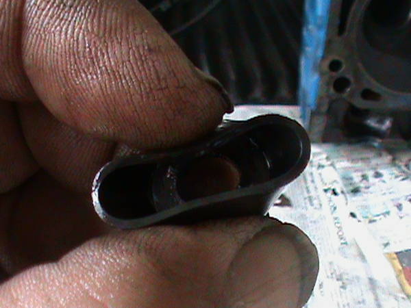

Although these will be washed and cleaned in solvent...ALWAYS check the oil passages for restrictions....
same with the pushrods...once cleared of oil you should be able to see through them..a light at one end is a good aid...

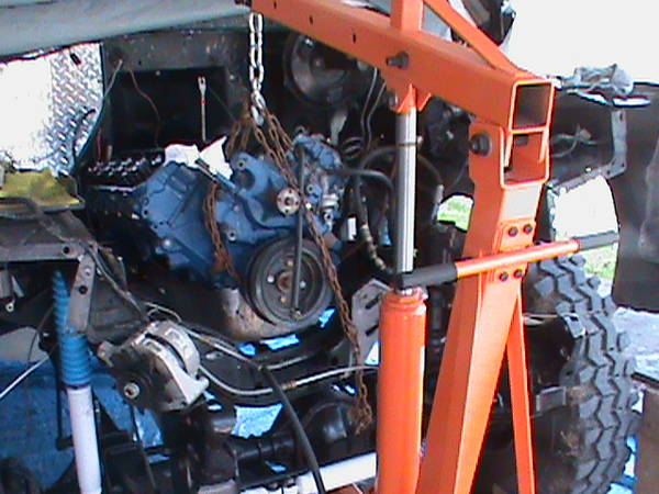

Trucks with headers...removal of engine mt nuts are eccential..

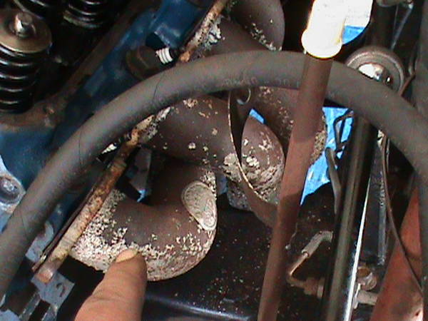

remove the header bolts / both sides

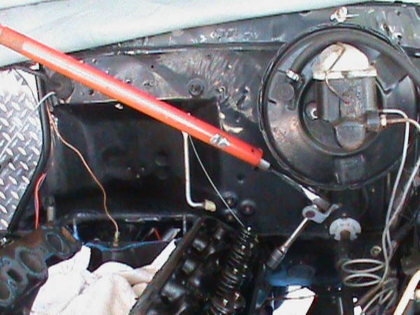

raising of the engine is required to remove headers from the vehicle..they remove from the bottom side...these will also be addressed while apart...
Cant get the "Buzzgun" in those tight area's..do what i do..Cheat...A long piece of pipe or in my case the jack handle makes an excellant leverage bar to break loose those head bolts...One hand on the ratchet head...while pulling the bar with the other,will keep the ratchet from slipping...

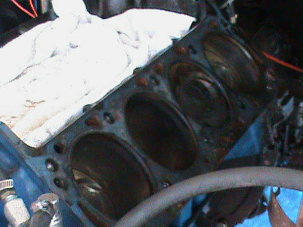

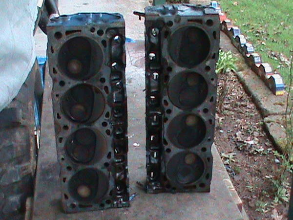

head removed...cleanup any Antifreeze that may have gotten in the cylinders ASAP Do not let it sit in there....once heads are removed cover the block when not being worked on...

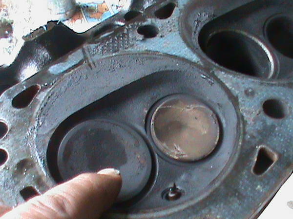

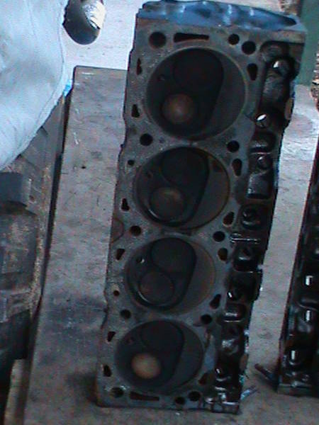

Right bank shows consistancy..a bit more carbon than i would like to see othewise not to bad...carb leaning should clear the carbon issue..
Left Bank...Houston...we have a prolblem.....I see oil in the two center cylinders...O S&*# gonna have to go deeper.......

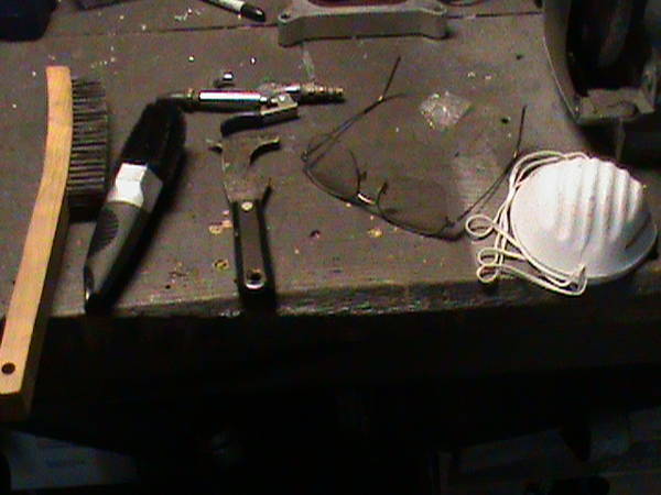

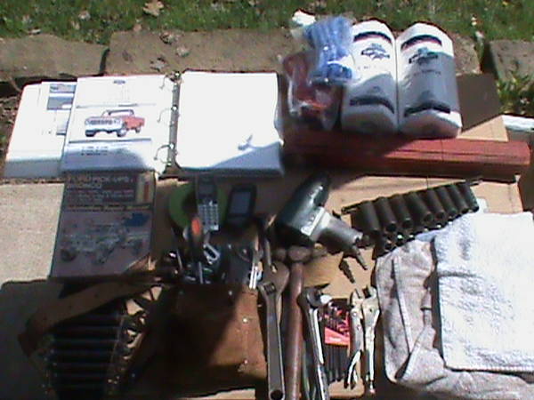

Ok Next up Cleaning and disassembly of heads some of the things you will need are......
Saftey glasses,scrapers,wire brushes,ect ect..

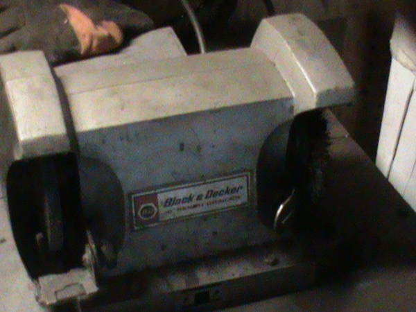

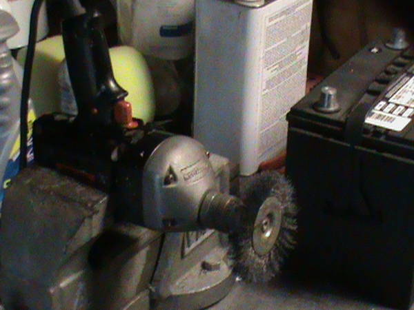

a Bench grinder with a wire Brush can be your best friend..this one will see a good deal of use in the coming days.....
no Bench grinder...well use your drill mounted in a vise works just as good...saftey glasses on please....
A simple drip pan to cleanup parts works just as good as those parts cleaners in the shop.....

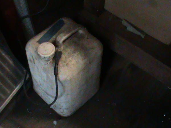

I use Kerosene as a cleaning agent....higher flash point than gasolene makes it pretty safe to use for the home mechanic,It also is a excellant cleaning agent....please use it in a safe manor away from open flames or sources of heat....

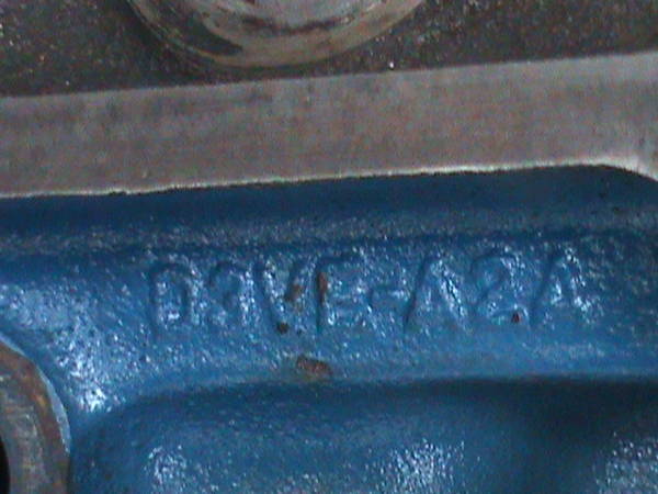

Ok Now that weve identified what we have here...let the cleaning begin...

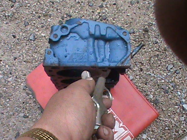

Tip #1 Before disassembly if you wish to check for seat leakage at home,here is what you can do...Place the head on a cookie sheet with the combustion side up..then fill the chamber with some kerosene,let it sit..if the kerosene leaks through..the valves are not totally sealing the chamber...valve/seat grinding is eccential to correct the situation...

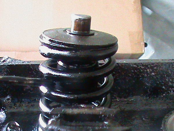

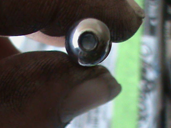

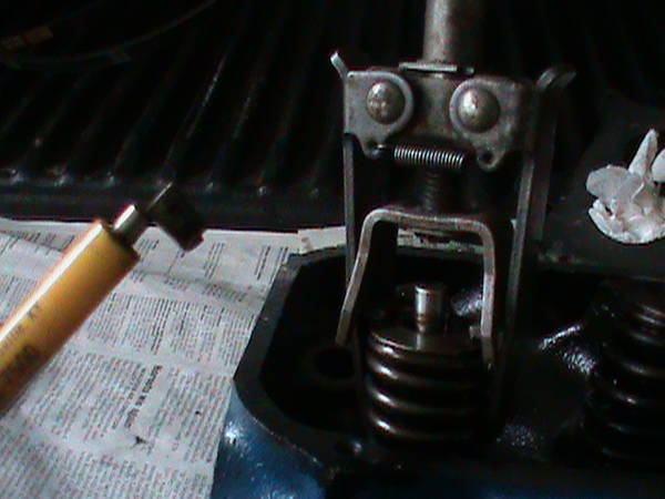

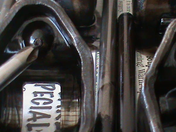

Using my valve spring compressor tool,ive compressed the spring sometimes you may have to rap on the top of the tool to break it loose from the keepers,sludge and gunk can make them stick pretty good at times...using a pocket screw driver with a magnet is best to remove the keepers..use care and do not loose them..place them all in a sealable plastic bag you will need these later for reinstallation..do this for each valve..Remember keep the valves in order in relation to their locations..I cannot stress this enough!!

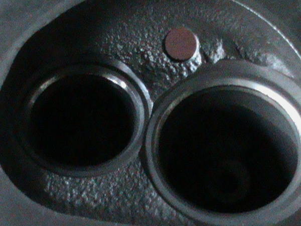

tip of the screwdriver shows the location of the valve seal,im going to go over some pointers of the seals.....
Pic shows how the seal is pliable and soft..these were installed about 2k ago they should be still soft...most cases they will be hard and brittle or completely missing.Through my yrs of experience these 50 cent seals can reak alot of havoc on an engine for when they break they have nowhere to go but in the oil pan,Ive experienced cases where the oil pickup will pick up a piece and lock up the oil pump along with sheering off the distributor gear..these seals can be replaced WITHOUT tearing the engine down by shooting compressed air through a fitting screwed in the spark plug hole.Another tip I always use these type of seals in a non Ford engine as well where applicable..if they will clear the valve spring these seals give the best valve stem/guide seal out of all of them imo...

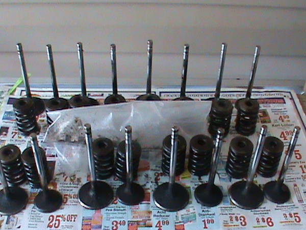

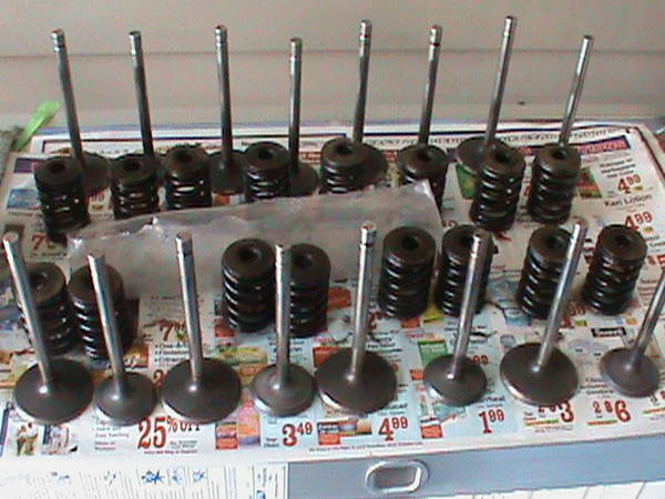

layout of valves in order of relation..again top row Passenger side of engine,from left to right...front of the motor to the rear!! Bottom row Drivers side ect ect...along with my baggie of keepers and the valve springs in order and related to its valve....pic is for a reference i will be upgrading the valve springs in my build we will get to this a bit later on.....
Again cover your parts!! it keeps out debri along with moisture

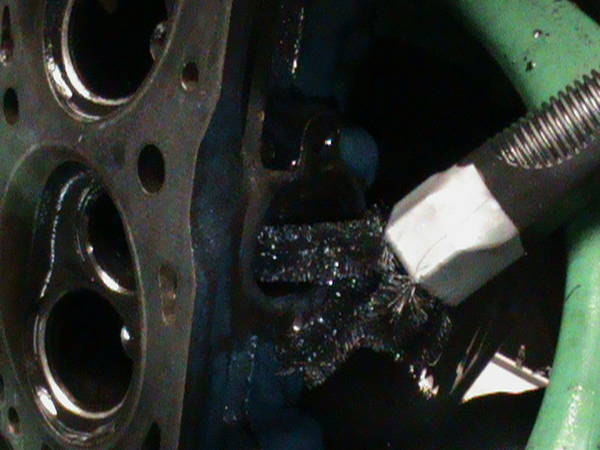

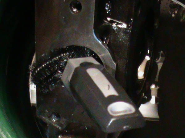

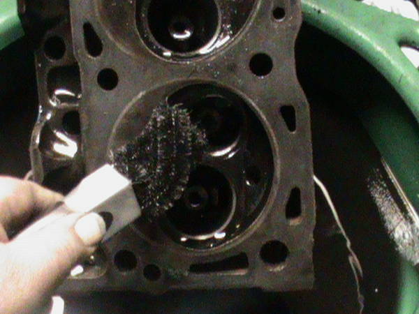

stick the head in your drip pan of kerosene begin scrubbing the entire head removing all sludge tarnish ect ect use your brush and scrapers...remove ALL the gunk...in some cases you may have let the head soak or repeat as needed...dont forget the ports....
cleaning exhaust ports....
cleaning intake ports...dont forget the topside..(not shown)

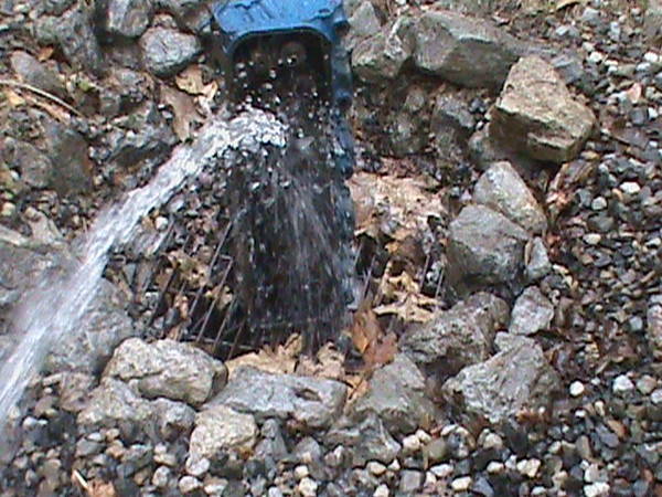

once cleaning is accomplished flood rinse with water using a hose or power washer if you have one.....
use compressed air to dry the standing water...use the air to Remove ALL the water..blow through the ports,water jackets,bolt holes completely leaving no stones unturned...

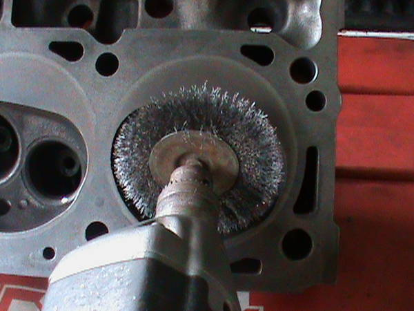

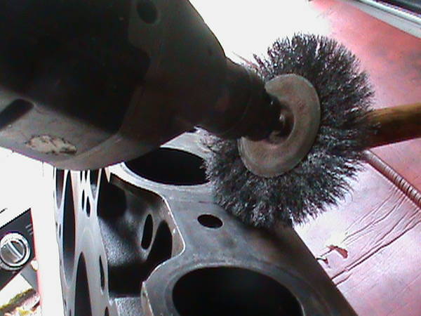

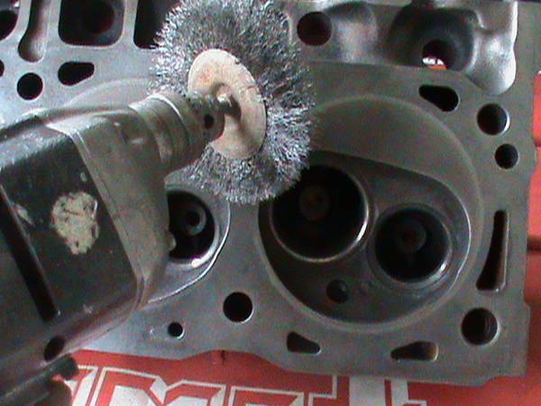

Next begin cleaning ALL Gasket surfaces,valve chambers ect with the drill brush...the surfaces will get to a shiny smooth silver color after all material residue is removed
two hands on the drill please at all times!!!
wire brushing the valve chambers
the intake/exhaust ports..clean,clean, clean...I want to be able to eat my lunch off these babies!!!! :)

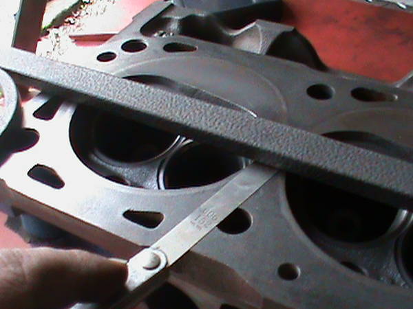

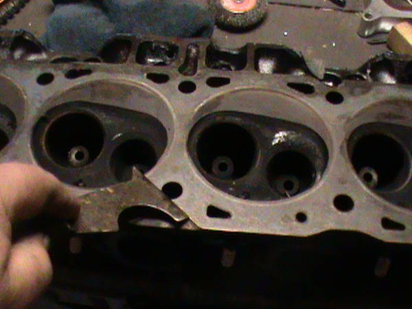

This illistration is for those of you who have overheated your engine at some point...you will need to check for warpage of the cylinder deck..taking a straight edge and feeler guage measure the gaps between the bar and the contact surface between the cylinders..compare your readings to specs..if your under specs the heads cylinder contact surface will need to be milled by a machine shop..you will also want to check for cracks in the combustion chambers,or in between cylinders is most common area's and usually can be visible with a magnifying glass along with a coat of kerosene laid on the surface will highlite cracks for the home DIY...These heads are now ready for seat grinding/ porting....To be Continued......

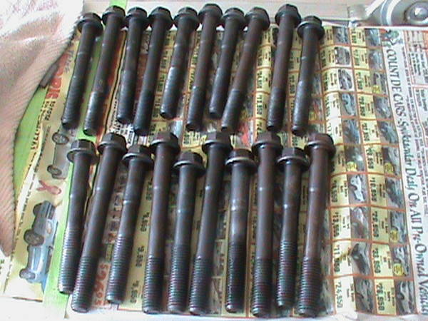

Next we cleaned all related valve train components...rocker arms,push rods,valves,head bolts...using the bench grinders wire brush....

Now we are ready to grind the seats along with some minor porting...for this application a cleanup of the castings in the chambers along with removing sharp edges in the ports will be all that is eccential for this build im not looking for upper end rpm....these heads although somewhat restrictive on the exhaust ports, are adequate enough for this build..intake ports flow like Niagra Falls....Here is a link on porting the D3VE-A2A Heads...It covers the technique pretty well pending on your application
http://www.reincarnation-automotive.com/D3_specific_porting_guide_page1.html
