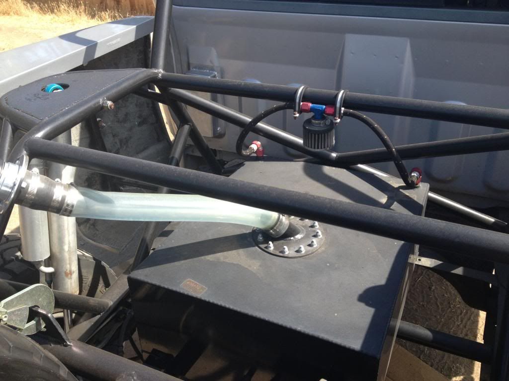

So, right now I have a fuel cell that came in the truck when I purchased it. I realized that it was not smog legal when I bought the truck and I knew I was going to have to do something about it to get it smoged in the next year. I DONT want to have some sketch ball smog it with a fuel cell and I DONT want to keep the fuel cell and try and make it legal, because you ultimately cant. I want to run a bronco tank, but im not sure what all I need to completely do the entire thing. I will be posting pictures and everything of what I have right now and when I get all the parts I will be posting pictures on how I did it. I just need help figuring out how to make this work.

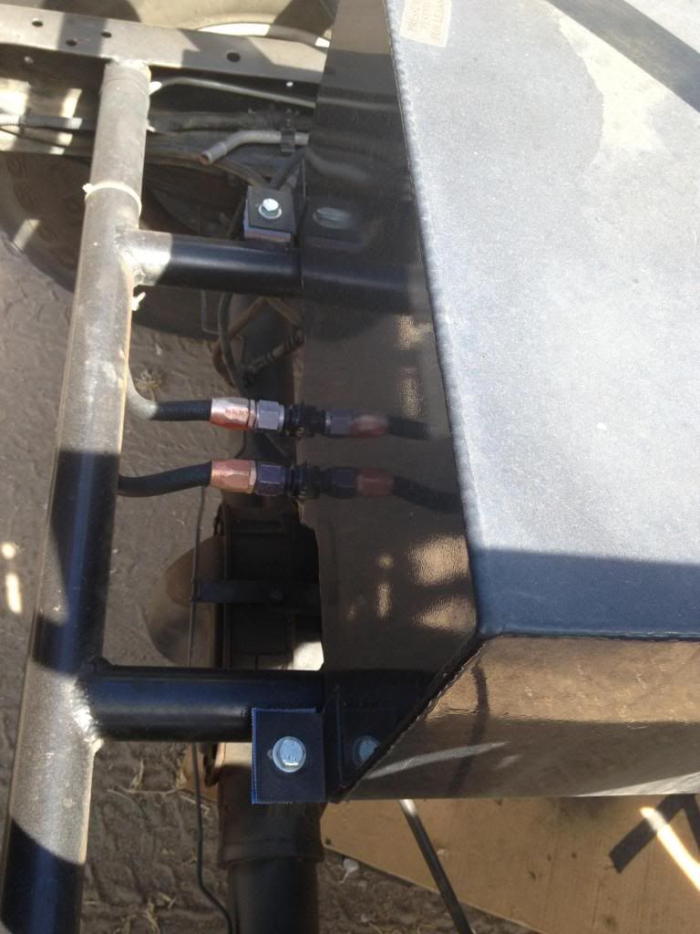

Here is my setup as of right now and I plan on putting the Bronco tank in the same spot.

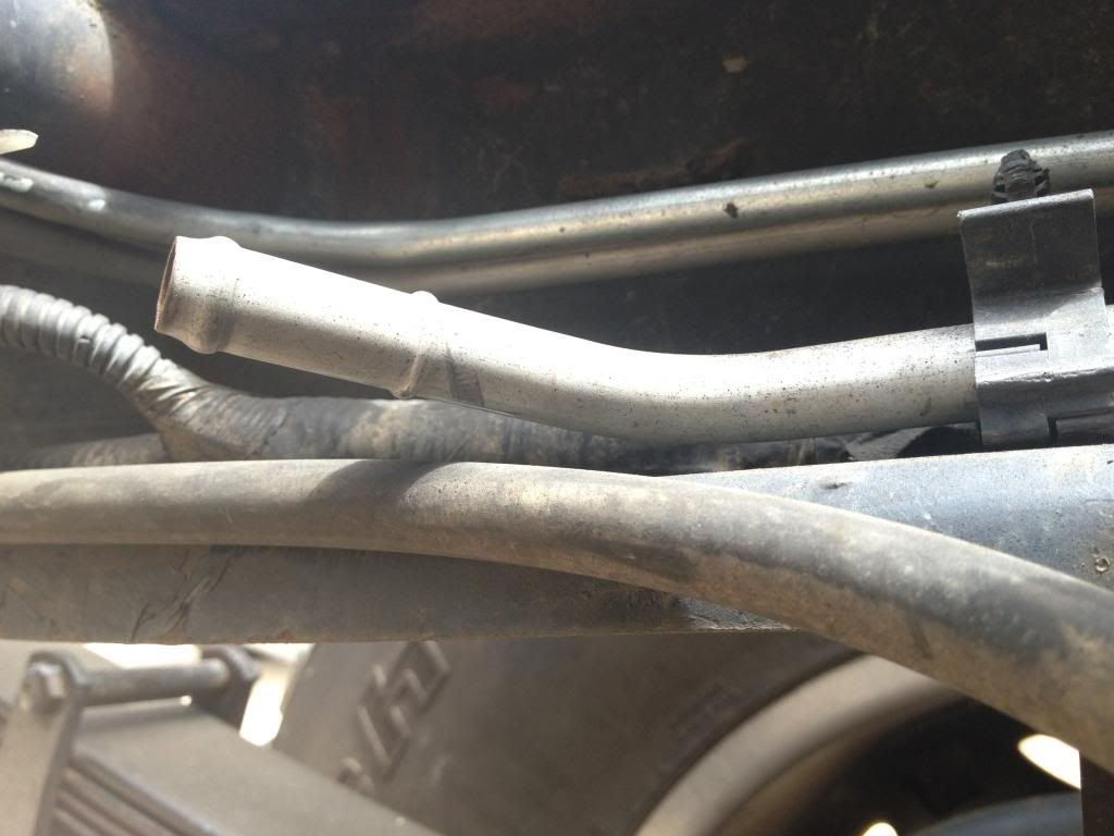

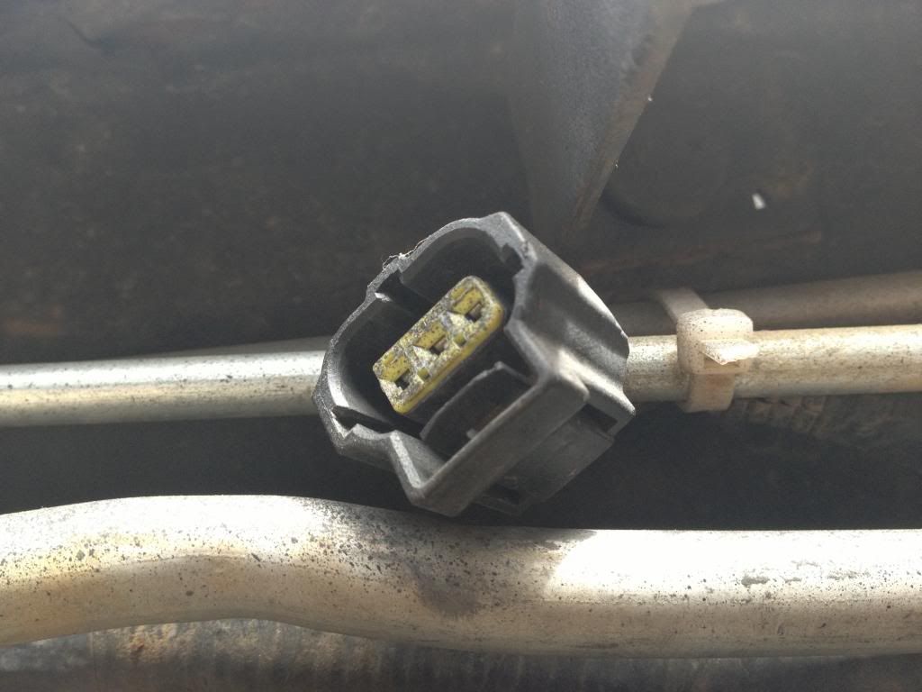

Here is a line and a connector that I dont know what they go too. If you could help me with that, that would be awesome :]

I really wouldn't want a stock tank back there.
To make it emissions worthy, change the cap, and put a vacum system into a charcoal can.
I would bet that line in the frame runs right up to where the charcoal can was there at the battery. Search it out

Actually he can't use anything lower than a 90.
85-89 had a low pressure lift pump in the tank, and a high pressure pump in the rail.
90 changed to fuel delivery module, 1 high pressure pump in the tank.This pump however used the same electrical connection as the previous low pressure pumps
To get plug and play wiring, he would need a 85-96 tank,and a 93-96 high pressure in tank FDM, with a wire harness attached to the pump
