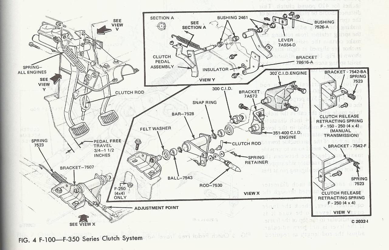

Hello, I'm new to all of this and I hope I can find some help here. I just picked up a '77 F250, 2wd with the 351 Modified. I was driving to the parts house the other day and pulling up to a stoplight, the clutch all the sudden went straight to the floor and the truck started making a rattling/grinding noise which I'm assuming came from the transmission. The long rod that runs from inside the cab to near the adjustment bolt appears to have broken, and the adjustment bolt fell out. I recovered the adjuster, but I've never put anything like this back together before. Does anyone have any experience piecing together a clutch linkage like this that could offer some tips? Specifically, I'm looking for someone who could type out sort of a list of which piece connects to which, from the pedal itself to the point where the lever enters the transmission.

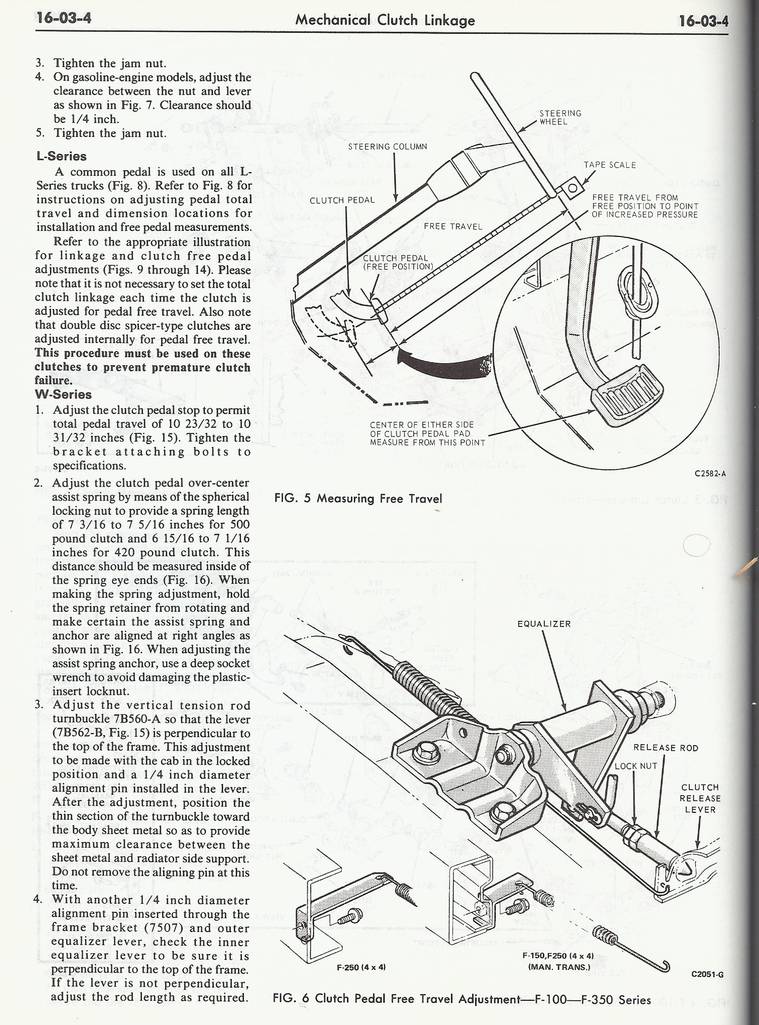

You beat me to it Doug :D
Also, I didn't look to see if there are differences, but here is the 1977.

If you have a copy of the LMC truck catalog, check out the bottom of page 115 on the bottom half of the page you'll find a section that has the heading Clutch Release Components for the 73 - 79 F-100 - F-250 , and the 78 -79 Bronco there isn exploded view diagram with numbers for each piece, and the numbers correspond with the list under the diagram with each piece and the names of each piece listed, it would be helpful for you to look at. Here is their web sit http://www.lmctruck.com hopefully you find this bit of info useful to you.smilieFordlogosmilieFordlogosmilieFordlogo
Does this help?

LMC's catalog info for clutch related linkage parts is incorrect for 1977/79 F100/350's and 1978/79 Bronco's!
Clutch release rod that attaches to the clutch pedal bellcrank, then routes thru the toe board to the equalizer bar has 90 degree ends supported by nylon bushings.
Nylon bushings crack apart/disintegrate, the 90 degree ends begin to crack, eventually snap off. Clutch pedal drops to the floor, lays there like a drunken sailor.

Serial number is the last 6 digits of the VIN
C8TZ-7521-D .. Clutch Release Rod - 17 5/8" long / Reproduced
1968/76 F100/350 / 1977 F100/350 before serial number O80,001.
D7TZ-7521-A .. Clutch Release Rod - 18.20" long / Reproduced
1977 F100/350 from serial number O80,001 / 1978 F100/350 & Bronco before serial number BA0,001.
D8TZ-7521-B .. Clutch Release Rod / Reproduced
1978 F100/350 & Bronco from serial number BA0,001 / 1979 F100/350 & Bronco.
2) C0AZ-7526-B (replaced C0AZ-7526-A) .. Clutch Release Rod Nylon Bushing / Reproduced
1961/77 F100/350 / 1978 F100/350 & Bronco before serial number BA0,001.
2) D8TZ-7526-A .. Clutch Release Rod Nylon Bushing / Reproduced
