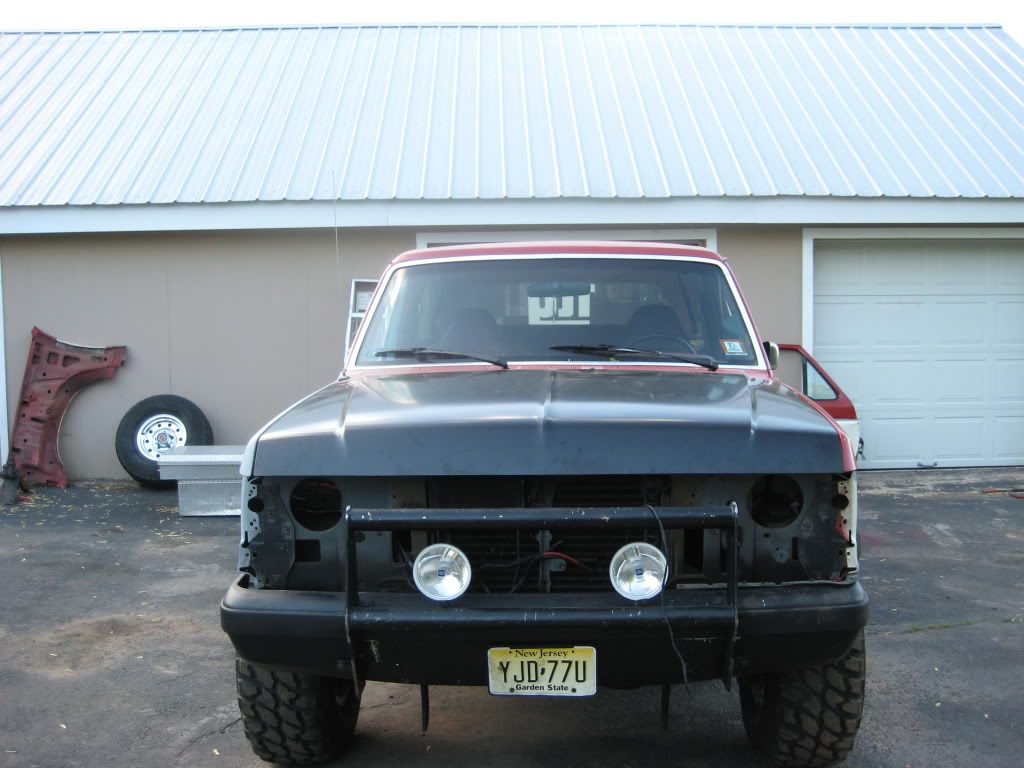

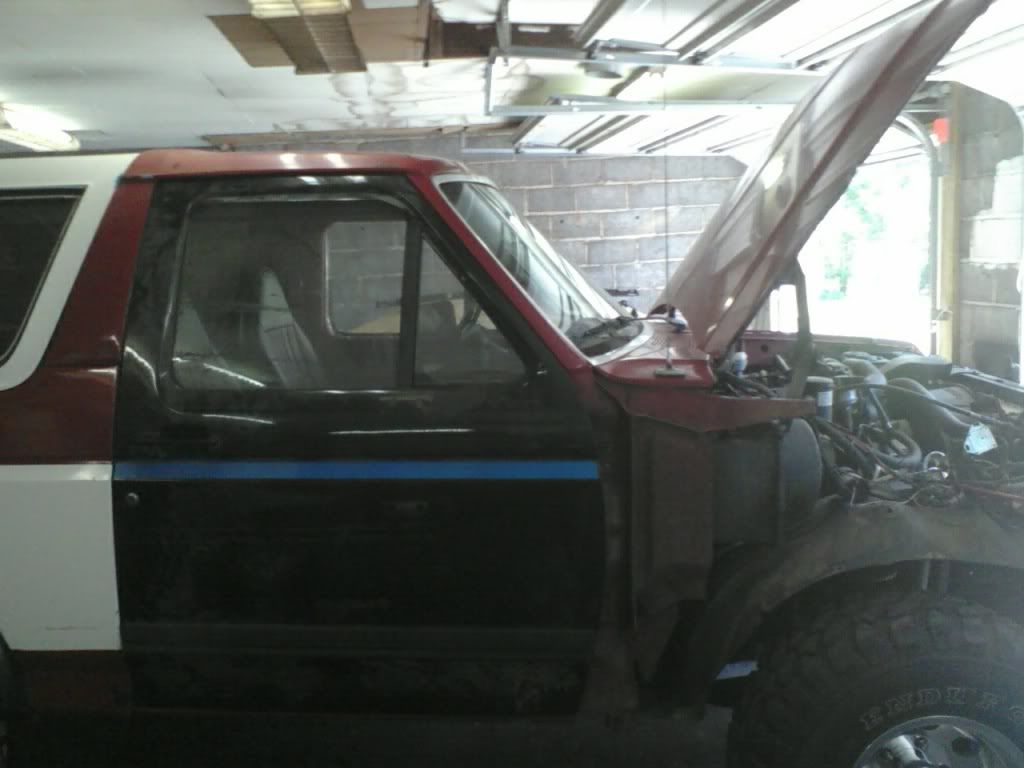

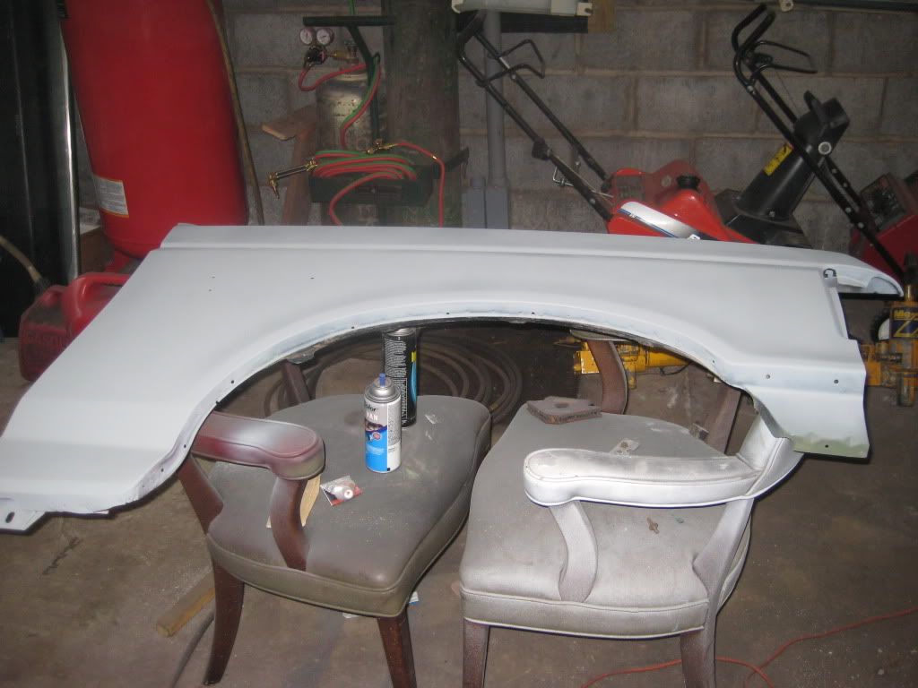

Well I didnt take too many pics, just with the cell. Took the passange door and fender off, as they were hit years ago by who knows what, and were all rotted out from the skin splitting. Got the door on but had to do some work to the fender before I put it on.
I have to order a new upper stone guard(part under grill and headlights). My plow messed it up, plus it was bent when I got the truck.
Have to change the drivers rear wheel well, just got the patch, and then I have a new tailgate to swap, and new head lights and grills comming.

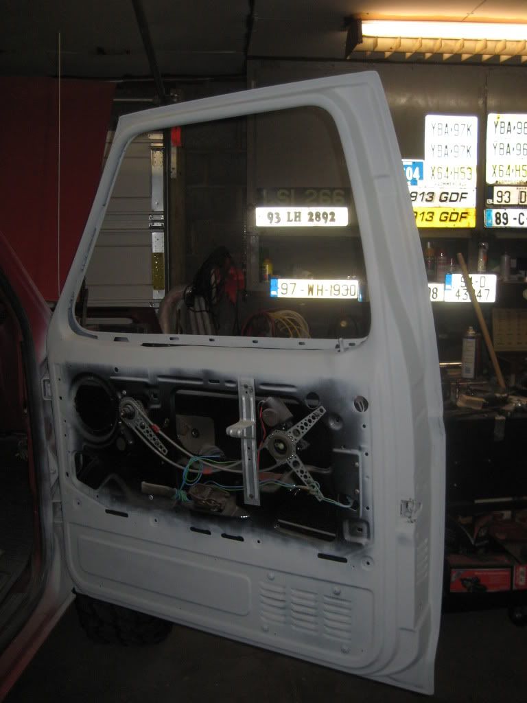

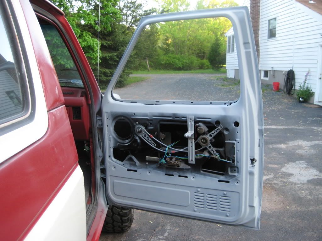

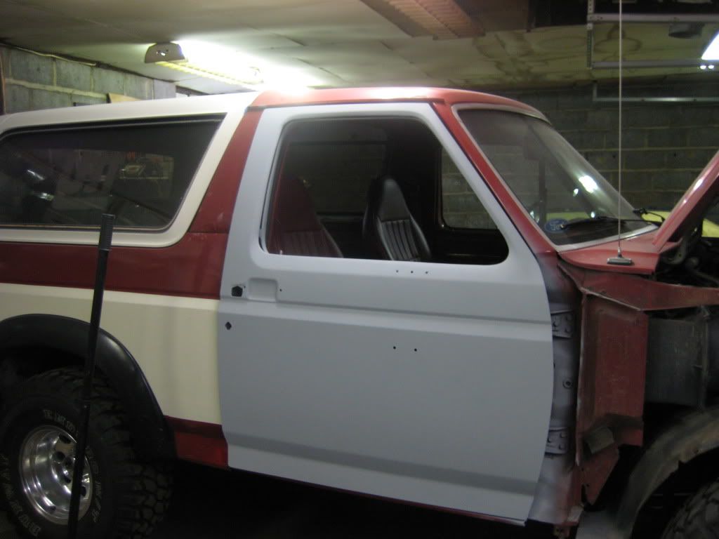

Took everything outta the door, sanded it down, took the Night stripe off, was a pain lol, with heat gun and all. Sanded it down and primed it up, also got the fender in full primer too.
Here are some pics, door was a manual crank, converted to power, and power locks were added, they will be comming out, and factory power locks and windows will be transfered from my old door.

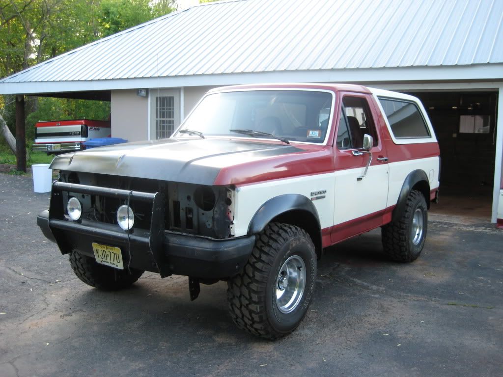

So I got the NOS factory hood on, aligned up the fenders, and am just waiting for my upper rock guard. Had to pull the drivers fender out more to get it to line up with the hood. Truck is kinda twisted or something, frame is bent in the front, and passanger quarter was changed way back.

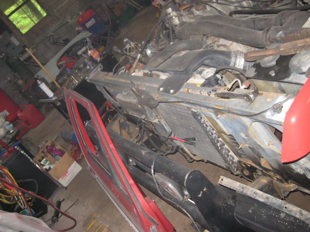

Here are some new pics. All lined up and latched up. Put battery and all that wiring back in. So now I can start it up and move it around.
Drivers gap by the bottom of hood, tightened up when I took it outside so I have to readjust now.

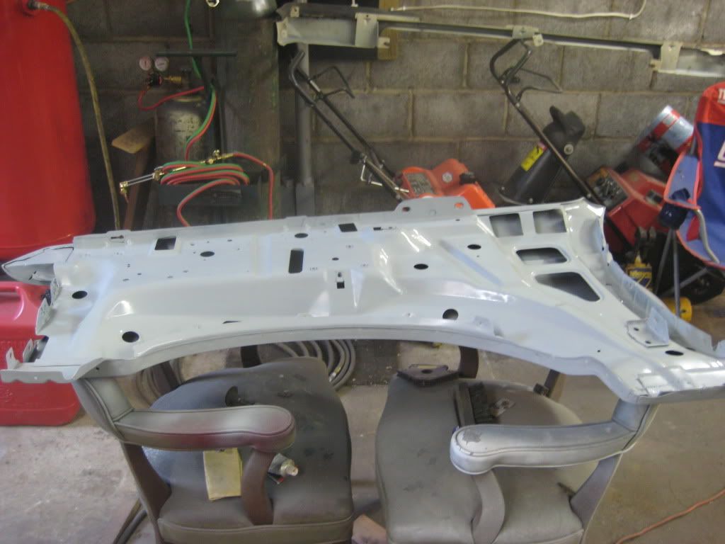

Took all the junk outta the old door I need, and took all of the junk outta the new door. Was a manual door converted to power, so it was hack lol.

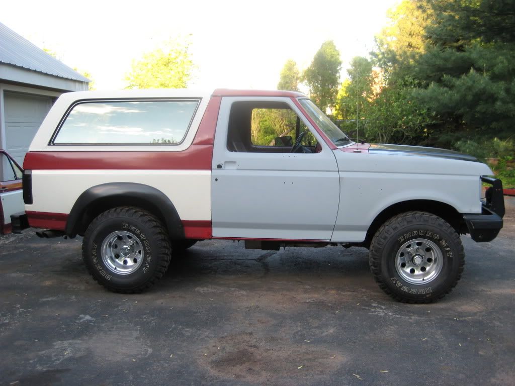

Cut out most of drivers floor, made new patch peices, welded em in. Onto drivers side now. UGHHH hate this kind of work. Rather make stuff run good.
Floors all done, even the part of the rotted quarter inside the drivers door has been cut out and a patch made for it. Better then factory. I grinded the welds inside where you open the door, the rest will have trim and carpet over it. Now I have to take the top off and weld where the metal split by the drip rail, and then the drivers rear wheel well is next.
