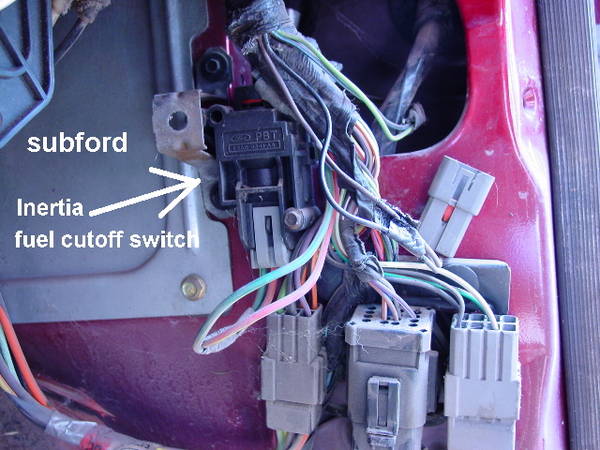

disengage the inertia switch and start the truck till it runs out. there'll be residual but not the blinding blast

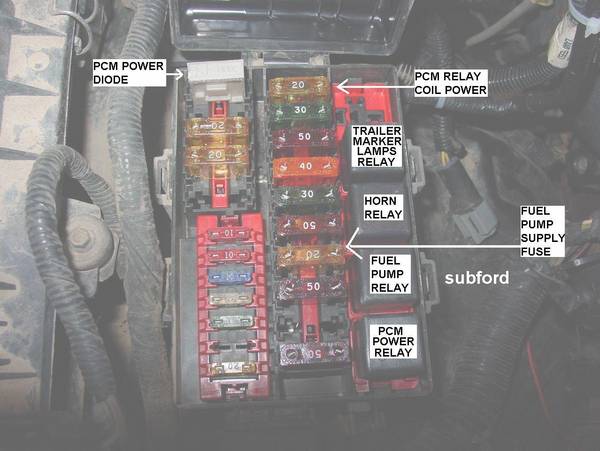

I think it is a little easier to just pull out the Fuel Pump relay and start the engine.
that requires opening the hood, finding the correct relay, and maybe throwing a code. the inertia switch is quick and painless. and easy to reverse. the relay can be tough to get back in correctly if you aren't a circus contortionist.
You are joking, right?
The inertia switch is behind the passenger kick panel and I just hate to remove them and put them back in.
For the Fuel Pump Relay you just pop the hood, lift the cover on the Fuse Box and pull the second relay out and it just pushes back in when you are done.
If removing the relay gives you a code then the inertia switch surely will, as that is the circuit the PCM is testing.

no...i'm not kidding. my inertia switch is right behind my brake pedal. next to my fusebox. 3 seconds and it's disengaged.
my pump relay is much more effort to get to , open hood, remove cover, locate relay, pull said relay, back in truck, start truck....the inertia has Never given me a code. pulling relays have.

ps. I'm with subford. Not sure on your setup Carl but the inertia switch is behind the passenger kick panel in my truck.
