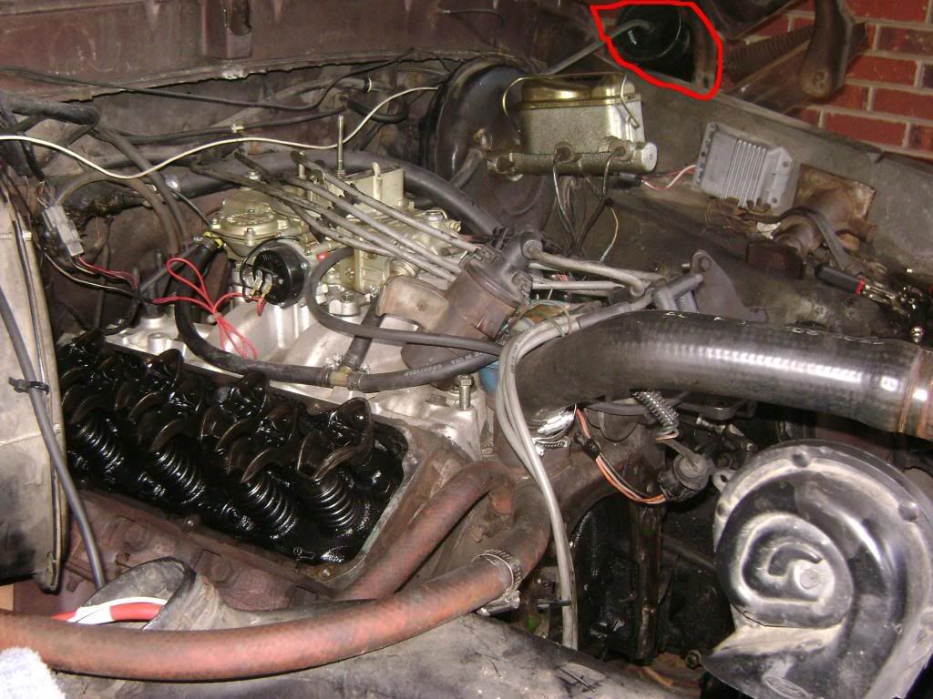

Do you have the vacuum resevoir on the driver's side fender?
I think the charcoal cannister goes on the drivers side under the inner fender.
78F250
New Jersey Chapter member
I used the wrong terminology. I didn't mean charcoal canister. There is no resevoir. On passenger side is the can, battery tray and some fuses closer to the firewall. Driver side has the jack and place where the windshield fluid resevoir used to be.
Sorry...didn't have a better pic, but I circled in red what I think you're talking about...is it right?
That IS the vacuum reservoir
If you have AC or speed control.. you need it.
If you don't like it but need it , mount it up inside the wheel well like on the 79's
Guys if it is on the drivers side it is probly the vacuum. But he says this is on the passenger side which would be the charcaol canister for the fuel tank vapor. It collects there then is drawn in the carb to be burnt. Most that I have seen the hoses are cut, non-existant, or degraded to the point they just fall off.
The Carbon Cannister is located low down on the passenger side.
One hose goes to the Air cleaner.. the other goes to the fuel tank

Thats a Vac can all right.. But i've never seen one that says any thing on it, but the MAN i'm sure is for manifold not sure what the amp means..
The CC is normally plastic.
