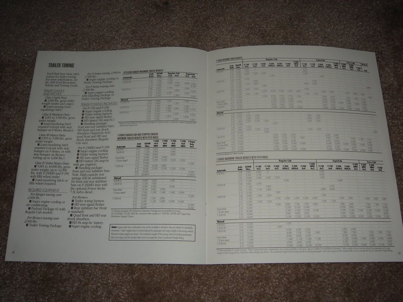

While we're at it, lets talk about tow ratings a little. I know it depends on all sorts of stuff, but roughly what would be the heaviest trailer I could pull with...say...an extended cab, short-bed F-150, 4x4, 5-speed with both the 302 and 300, and whatever would be the "most common" gears to find behind each engine. I know there's lots of variables...but are we talking 3000 lbs? 5000 lbs?

Im gonna be the Gen8 guy on here. You will want to find one with limited slip (I like my 3.73LS) and a manual transfer case. That way it will be very difficult to become stranded somewhere. The M5OD (I have one) is a decent transmission, mine went 135,000mi before it needed mild reconditioning, and it didnt cost too much. The 300 is a great motor and most people that experience driving one, prefer it over the 302 (less power, but way more low end torque). Fuel mileage is good from the 300 (16-18 combined, 21 is my best) but nowhere near the numbers of the (carbureted) Gen7 trucks (mid20s). It tows my dads 4500lb boat/trailer really nice, though you may have to downshift on hills. In 1996 Ford converted to OBDII along with the other automakers due to federal mandate, meaning it will be easier to get a computer reading from it, however many states have stopped smogging pre-OBDII vehicles because of the lack of outdated machines to scan them, making OBDI more desirable. As far as interiors, I have heard people go both ways. I like the driver area of the Gen8 trucks better, but I like the dashboard of the Gen9 better. I think the door panels of Gen8 trucks are way cleaner than a Gen9 truck, but Chris hates them... it all comes down to preference.
Look at this cool Dealer brochure for a Gen8. http://storm.oldcarmanualproject.com/fordpickup1988.htm
