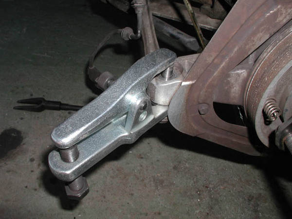

Its best to use a splitter Joe - saves strees and agro.... a tool like this will do the job and is pretty cheap.

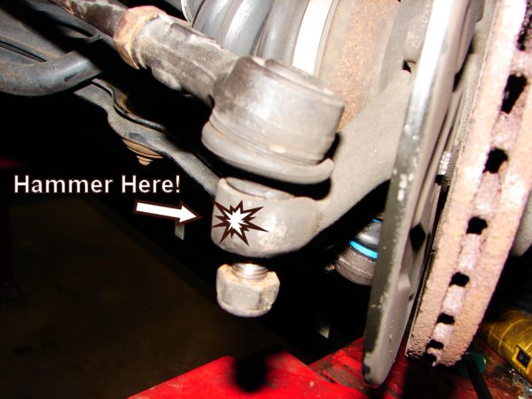

But if you feel the need to hammer away hit it just like this and 2 or 3 whacks with a medium BFH will sping it out ..... normally any way - sometimes when i'm doing them i will use the tool and put tension on it then give it a tap with the hammer just to spring it.
Hope this helps .

No you won't need to take brakes off - if you use the tool i put a pic of in the second post you will have no trouble.
No you won't need to drop the tie rod to change out the ball joints - just jack up the truck and put some wooden blocks under the frame rails and remove both front wheels at the same time so that it's easier to turn the hubs ... make sure you use blocks and not jacks to hold the truck up and chock the rear wheels too - idk what the front of one of these things weigh but i'm sure you aint gonna be able to lift it off yourself if it falls off a trolley jack .... been there and seen the results - NOT pretty.
Ok with all the safety drama out of the way remove the split pin from the castle nut on the ball joint take off the castle nut and then put it back on the ball joint upside down - screw it down so that it is level with the top thread on the ball joint .... what you do this for is to give the ball joint tool more "meat" to get a grip on then fit the ball joint seperating tool to the ball joint and tighten it up - if you are lucky it will seperate with a loud bang but more than likely you are going to need to do the ball joint splitter up as tight as you can get it then tap the housing around the ball joint with a hammer - you may need a drift or a punch to access it ... when you hit it give it a bloody great whack and it should spring the joint out .
