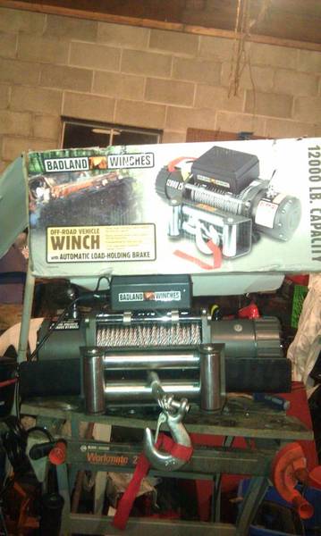

Got the winch mount finished tonight about 9pm and the winch mounted to the mount. Dang work and family takes up a lot of garage time :)
Hooked up the wires to a spare battery and spooled out the cable and spooled it in. The line speed is pretty fast which surprised me as the older Harbor freight winches were on the slow side.
Now I am working on fabbing up the front and rear receiver hitches for the truck.Also have a Idea for a temp bumper ball mount I am working at.
Will get a few better pics in the day light.
Need to pick up some wire and quick connectors so I can mount and un-mount it quickly.
Here is a bad cellphone pick of the winch.

Here is the review of the Badlands Winch.
Overall I am impressed with the winch.
THE GOOD:
It has pretty good line speed and plenty of pulling power.
I drug a car that was sunk down in the dirt to the frame and it never even struggled, all four wheels were locked up tight.
It will run a battery down so a better alternator or a dual battery setup should be considered if you plan on using it a lot, this is not the winches fault just the nature of the beast.
THE BAD:
The roller fairlead that came with the winch is to light weight for the power of the winch.I tweaked it testing it on a angles pull. I will beef this up with a few 1/4 inch plates and it will be fine.
The supplied power cables are a bit on the short side so if you plan on mounting it you may need to get longer cables.
From the limited testing of the winch I would recommend it for a cheap security out on a trail or pulling a few things around the house.
I would spend the money and buy another and for me the tightwad to say this is a thumbs up.
