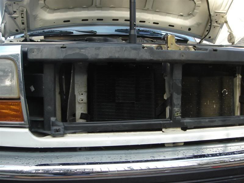

Finally got around to installing my trans cooler last weekend with Trista's dad. It was a little bit of a hassle since the new one is a different size and mounts on the top and bottom, as opposed to left and right (like the old one).

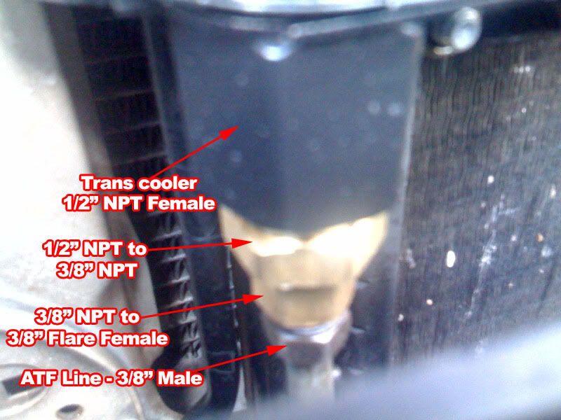

It was also a hassle because the new cooler has 1/2" pipe threads while the old one accepted a 3/8" flare fitting. We couldn't find a 1/2" NPT -to- 3/8" flare anywhere... So we got 1/2" NPT -to- 3/8" NPT, then couple that with a 3/8" NPT -to- 3/8" flare. Wrapped everything in teflon tape, made some brackets, and threw it together. The install went pretty well and when we got back to Trista's house it was still dry as a bone.

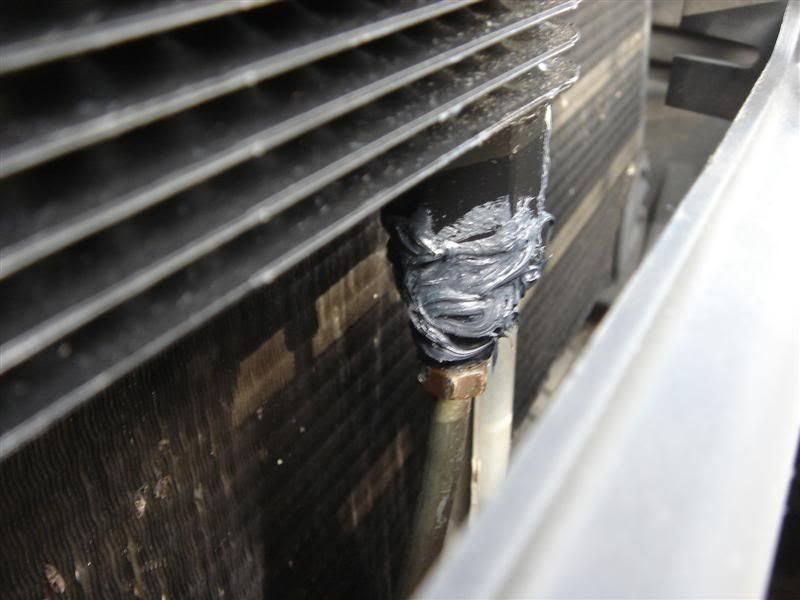

So I drove the truck to Davis and check it again when I got there-- the bottom of the cooler lines where they make a 90* angle and head out in different directions had drops of ATF hangin' off :headbang: It looked like a pretty slow leak so I left it until this weekend when I could take the grill back off and have a look. Took it off today and found that the leak was happening somewhere around those brass fittings (duh). The topmost thread-to-thread contact (1/2" NPT) was damp, as well as everything below. So it could either be those 1/2" threads that are leaking and dripping down, or EVERYTHING is leaking. Called Brad and tried to brainstorm a good solution that DIDN'T involve removing the cooler and making a mess-- couldn't come up with anything. I asked if he thought smearing RTV all over the threads might help, since it's a real slow/low-pressure leak. He said try it.
Well I had to rush home back to Davis to meet Trista so the RTV only had about 2 hours to dry (or NOT dry). I crossed my fingers and headed home. Got to Davis-- ATF everywhere again, like before :headbang:

Did you use teflon tape or thread compound. Also those hoses may need a double flare fitting to work.
I used teflon tape. What's a double flare?
Side note-- I did NOT use teflon tape on the flare fitting threads-- Trista's dad said not to cuz the flare makes the seal for you.

No tape on the flare but I need a better pic to get it exactly(maybe). Did you get the 3/8" flare adapters at an autoparts or hardware?
radialarm
Clown of Death!
A double flare folds the end of the tube inside. Try an autoparts for a double flare fitting. or you could cut the flare off and use compression like they used on your tranny lines at centurion. I think that's what I remember seeing on some of your old pictures.
