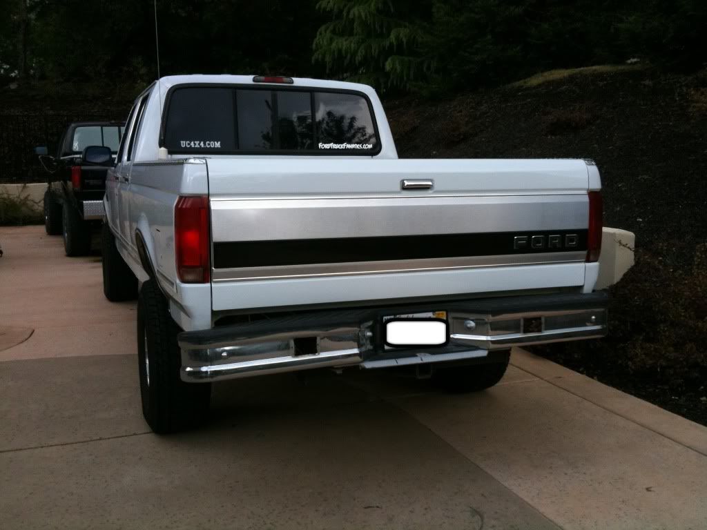

Here's the new gate by the way:

That's the old bent up bumper. The lights are already mounted in the brand new oem bumper that's sitting in my bedroom in Davis :rofl: i need an impact gun to get the bumper bolts loose so the new bumper gets put on in a couple weeks when i go to my moms place.

Looks good Chris. I'm glad she's coming back together. I know you have to be happy. It's just not right seeing a fine specimen such as Bertha all broken up.
