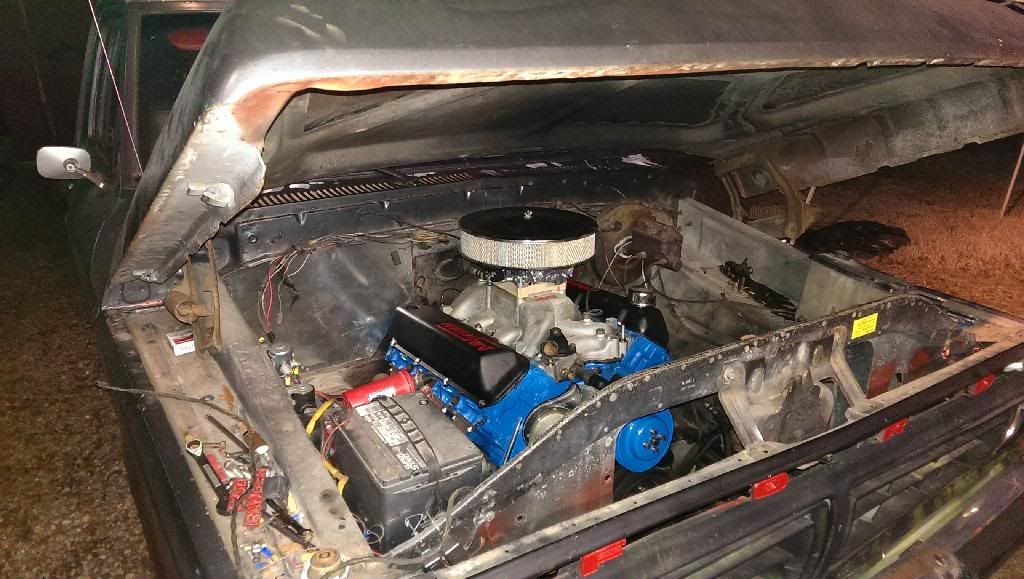

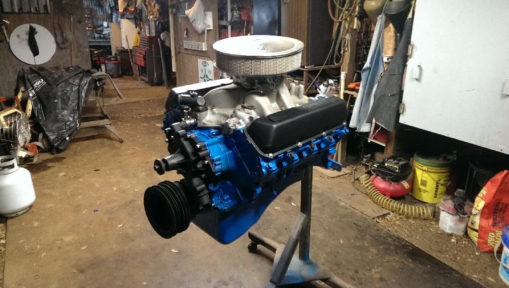

so im bummed i finally have the motor back together new cam lifters weiland stealth intake manifold 600 cfm eddy carb totally rebuilt by the master carb guy here and the msd ignition system with the blaster 2 coil new spark plugs new plug wires and i ran outta time so i have to wait till tomorrow to break it in and i have a couple of questions my truck is a 2wd and it has the front sump oil pan and that drain nut is like right at the crossmember what a pain is this normal 2nd question holding the engine at 2000 to 2500 rpm for thirty minutes sounds like a chore anyone have any tips so i dont have to sit there for thirty minutes with my foot on the pedal 3rd question how much hp do u think she will have the cam is a mild one with adv dur 262/272 with lift .479 .504 d3ve heads ported on the exhaust side with a valve job and a good set of headers please let me know

It's been a long time in the works but my truck is now ready to be cranked up. I've had it bored .30 over and installed a new stroker crank. Had my d3ve heads ported and polished added the straight up timing chain and recurved the dizzy. All tnx to help from the boys over at 460.com.I'll try to post some pics later. I just have one last thing to figure out. When I pulled the engine and transmission out together I lost quite a bit of transmission fluid . Now before i crank it up I wanna top it off but I dont know what fluid to use cause according to the dip stick it calls for a cj type fluid. Now everywhere I search they say to just use type f but from what I've read about the cj stuff it's like the newer fluids. Now I plan to drain the fluid to change the fliter and add a shift kit but fluid should I use to fill it back up with?
