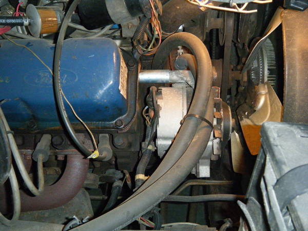

Alt bracket pic
upper ? Lower ?
what engine ?
w/Power steering w/ AC ?
What year truck ?

What engine???
429 I don't know what the brackets came off of, but Ford is stamped on them. I put them back the way they were, but I don't think they are right. I need to see some pics of maybe some bb and sb alt brackets on motors so I can figure out if they are on right or not.
Maybe post a pic of how you installed it and someone might be able to tell you if it looks right even though they dont have a pic

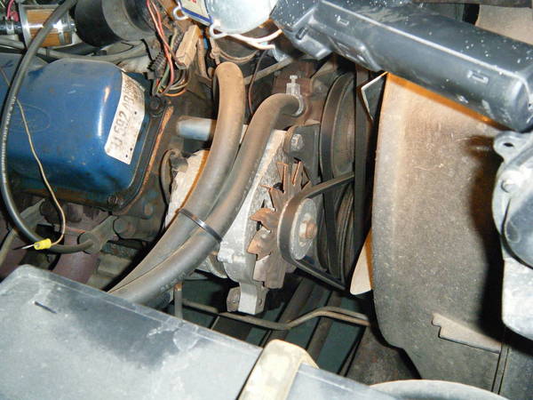

Not sure if this will help,but here's my 400 (complete with uber cool 3g Taurus alt:cool:). There's a long arc'ed bracket on the bottom.
This is from my 79...I don't think it's been molested:
I can take more pictures if these don't work for you.
Well I guess mine is right. I just don't understand why they put the tensioner bolt under and on the back of the alternator. It seems like it would be on the front where you could tighten it while you are putting pressure on the belt. I guess it is just a bad design. Am I the only one that thinks this?

Here's mine with the car brackets
The alternator Upper bracketry is a little different. The adjustment bolt is on top
