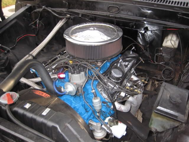

All depends. Are you looking to just replace the stock filter? OR go with something different? Here is my K&N filter which is higher than normal.
I still have this filter, but this picture is from my old engine. My new engine is black.

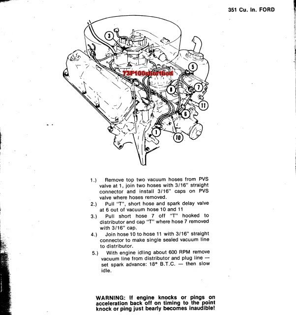

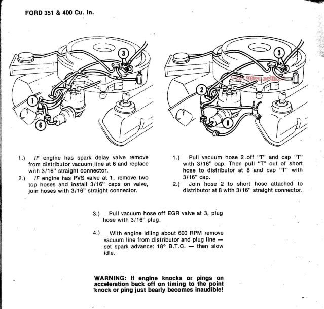

I have a book somewhere that shows what emissions stuff that can be removed LOL
I'd be really interested in seeing that book or at least getting a title of it so I can complete my statement above.
I can scan the pages later for you Ben if I get a chance. It shows blocking a few lines and adjusting the timing accordingly. I'll try to scan the 351m and 400 pages later.
Appreciate it, I think I have all the right things blocked or removed...but there are a few extra pieces still lying around that I'm sure are part of the smog setup, but I just wanna make sure before I clean up the bay.

Ben here are the pages. The book was written in 1974 so it may not have exactly what you have, but I'm sure it can help someone.
Thanks for the post Sean...I have all that covered...so I'm good to go. The only thing I have left that I believe to be smog related is like a white plastic canister in.on the inner frame rail in the engine bay. The only thing still connected to it is a tube that goes the length of the frame to the top of the gas tank. I dunno if it's still connecting to the gas tank, but I'm not gonna check until the tank needs to be dropped. Does anyone know the actually name for this piece of equipment?
