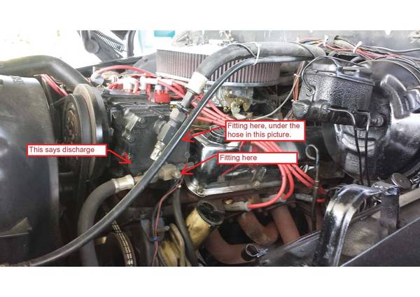

On the compressor, where do we add the freon and are there special fittings?
The mechanic said that the normal fittings on his recharge kit that he's charged on our newer vehicles are different and he'll go back to his shop and get the other fittings, but wanted to check and make sure where to charge....is it on the top fitting in the picture since the one on the bottom says discharge?
Or is it somewhere else away from the compressor? He said he has some buddies that are more knowledgeable with these ac systems than he is and will double check with them, but I thought I'd check and see since I know a few dents on here have AC....I know Buck just went through fixing his....I think, if I remember correctly.

The hose from the evaporator(upper hose in your picture) is the low pressure side, per the '78 shop manual.
The one in my photo Doug? This one? The top fitting?

The large hose is always the low side, small pipes and hoses are on the high side.
Discharge will be the high side, making the other side suction, which is the low side. You can charge it right at that fitting. They make adapters to charge those r12 type fittings with the newer 134a equipment.

Yes, Ken. The one that is labeled "fitting here, under the hose in this picture."

Thanks Fellas......she's Blowing Real Cold Now!!!!
bigdance
:wavey: :wavey: :wavey:
R134 and he had to use an adapter, but those bars that are protruding opposite of the valves acts like a shut off valve, but it seemed to work just fine.
