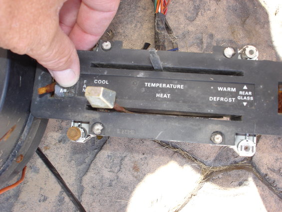

While I know that neither me nor Buck know as much as you do Bill I am most certain Buck knows about dealer add on air as well as I do. We don't have the "behind the counter" mentality to ask all of the questions like you do. I ASSuMEd that the OP had the factory A/C which he does.
I just happen to have one of these laying in my back yard. This is neither Economy, Deluxe or factory. It happens to be aftermarket and they used the Hi side of the fan switch to turn the A/C on. It looks identical to a dealer ad on A/C system BUT used the stock controls. You can see in the 2nd picture a stick on label that said A/C.
My 76 and the 79 I'm talking about with the plastic duct both have the factory units [your item 1]
So like I said in my 1st post yes it will.
