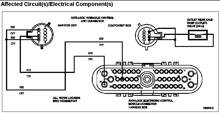

NO WAY, i searched for that, wrong area tho! lol i knew it was somewhere, well now we can discuss it over here. I have Code 27.. That is Rear Axle Outlet Solenoid Concern Diagnosis (Code 27) Is that something to do with the abs pump. I bought a new sensor for the rear axle not to long ago, that didnt fix it. Hey chris i woulda asked you but im on the other computer and messenger is not working on this one, sorry bud.
27 -- Open circuit to valve block or anti-lock brake electronic control module, open or shorted valve coil or internal anti-lock brake electronic control module damage.
Description
Code 27 is generated by the anti-lock brake electronic control module's detection of an open or shorted Circuit 510 (T/R) and by an open or shorted outlet rear axle valve coil or an open or shorted driver in the anti-lock brake electronic control module.
Possible Contributing Component/Vehicle Wiring Concerns
Intermittent open Circuit 510 (T/R)
Terminal backout in anti-lock brake electronic control module connector Pin 27
Terminal backout in valve block connector Pins 1, 4 and 3
Open or shorted outlet rear axle valve coil
Open or shorted driver in anti-lock brake electronic control module
