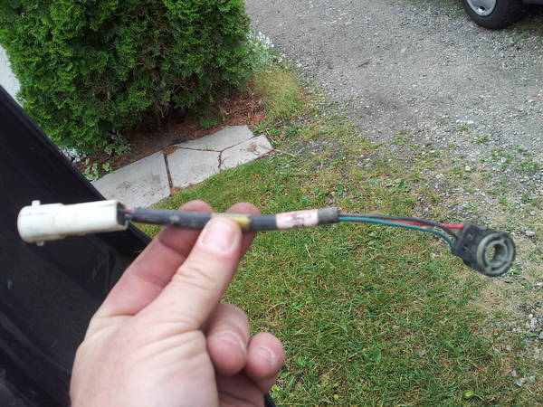

Does anyone know if the wiring harness in this picture, (found inside the door when i took off the panel) has anything to do with the fact that my interior light stays on and the door ajar light stays on in the dash board? It does have power door locks and i did notice that the bottom rod connecting the actuator to the lock mechanism was missing, i will replace the rod soon.
Thanks
darn it! cant upload pic... too big!! :( its a three wire plug, red green, black, with a circular female plug on one end and on the other end is an octagonal shaped reciever that looks like its supposed to slide over a nut? rod? or something like that...
help! lol :headbang:

The light switch for the cab light is in the door latch. Is it hooked up?
They are notorious on some trucks to stick a good dose of wd40 seems to cure this up if it is sticking.

do you know if the harness in my original post is part of the interior light system?
You know whats funny Fatherdoug... no where in my haynes manual does it show the wiring inside the door panels... gotta love it! hahaha
That's too bad, but it doesn't surprise me. They're good for general information......... I have no idea what that other piece is. Sorry.

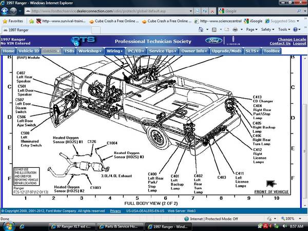

http://www.autolib.diakom.ru/CAR/Ford/1997/Ranger/SYSTEM WIRING DIAGRAMS/15619.pdf
All wiring for the 97
