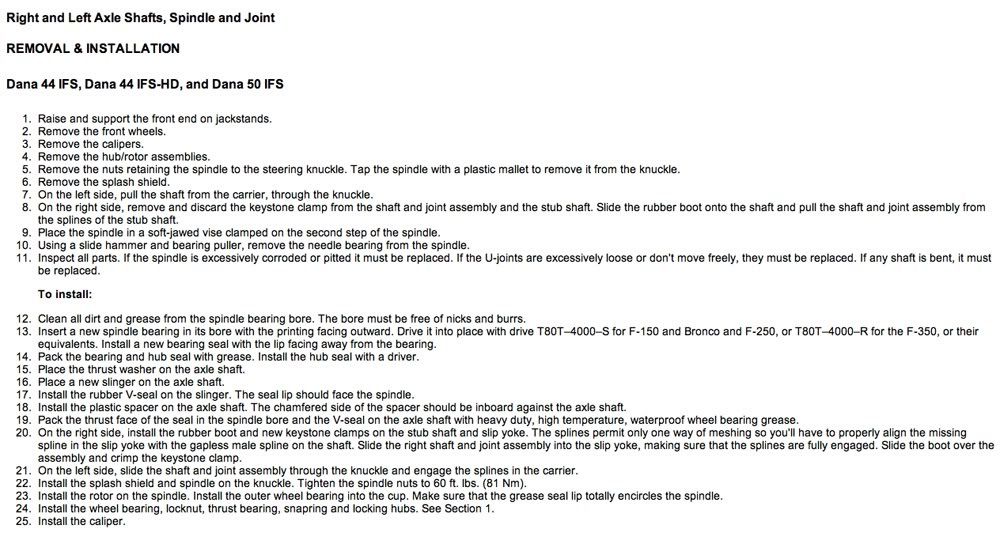

My online service manual (similar to a Chiltons or Haynes) doesn't offer much... Here's the instructions for removing the shafts, spindle and joints...

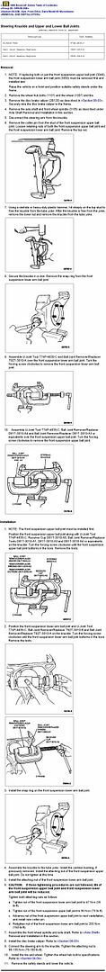

When I get home I can look it up in my Ford repair manual, which is a lot more detailed. Just so you can get a rough idea of the work involved... Here's the instructions for removing the spindles and then changing the ball joints for a 4x2 truck, from my Ford repair manual.

No don't use those instructions!! Lol!! That's for a 2wd, I was just trying to give you an idea of the work you had ahead of you.
Now that I'm back home, HERE are the instructions for the Dana 60 ;)
