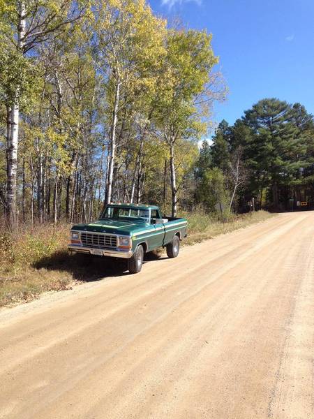

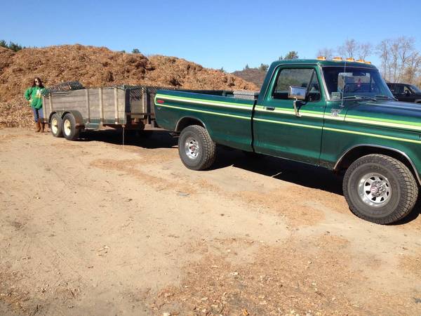

First an update!
I have wanted to drive my 78 to our lake cabin as long as I have owned it, and finally made the trip last weekend! 600 miles round trip plus a lot of exploring I would never do in my 14 Sierra (fire/log roads, gravel, woods)
WHATS DONE:
-Rear brake are done
-Rear lines from Jeff's Bronce Graveyard (very impressed with these and would recomend them if anyone is looking for
prebent lines)
-Master cylinder, wheel cylinders, drums and shoes plus the hardware kit
-33" Toyos mounted
-New sending unit so my gas gauge works
-New steering stabalizer

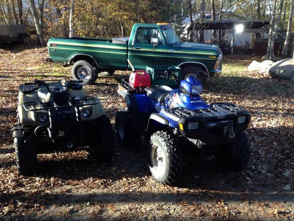

Nice pictures and a very nice truck! Is there a reason you have to stay with the 12.5's? 10.5's will do lock-to-lock with no issues.
