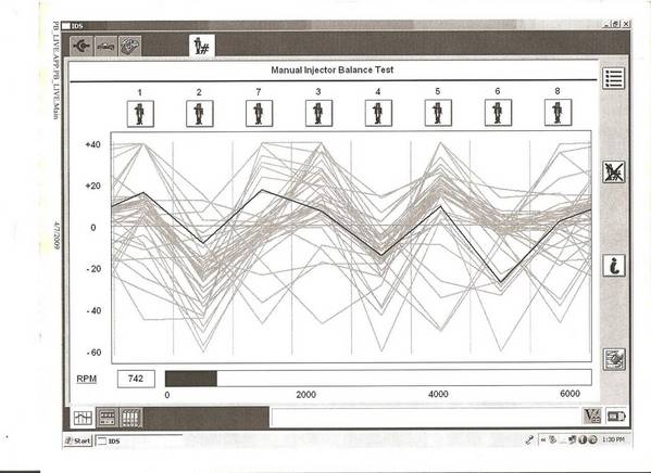

Little history....this truck had 8 injectors replaced, one month later had 2 replaced. This screenshot was after the truck warmed up. Customer said it had a cold start misfire.

FICM checks out OK?
FICM performance test checks out. After a while, you realize that those results dont mean anything. Essentially, this measures inputs and outputs. If theres an intermittent in the ficm, this sort of thing can happen. Remember, the ficm controls the injectors. Other possibles, ficm connectors, wire chafes (we all know this doesn't happen on a 6.0 :rofl: )
