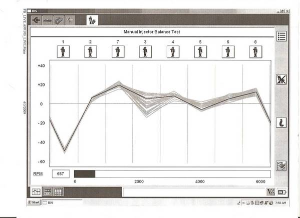

Heres a good reason why you should always bring your truck in the night before when getting your truck diagnosed for a driveability problem. My work order said "Truck misses at times when towing a load". The truck was brought to me already warmed up.
It plainly shows a weak cylinder on #1. Would replacing #1 injector repair it........NOPE!

Vince - is an injector balance test the same thing as a cylinder contribution test?
9,461
301
waynesville,mo.

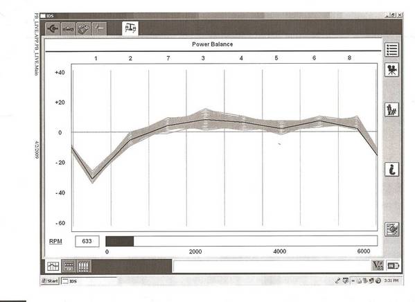

Close. Notice that the second display is slightly different? That display also lets me shut off one injector at a time. The ficm has a strategy that has it increase duty cycle in neighboring injectors to compensate for the misfire (the first display, look at the neighboring cylinders). The second display also disables this strategy for a more accurate look.

Wild stuff - being able to disable that strategy to diagnose the individual injectors.
A couple of other questions, if you don't mind me picking your brain a little..
Does the horizontal "0" line represent the theoretical perfect operational area for the injectors?
Is this chart measuring the average fuel metered per event?

The way I understand (or interpret) it, is that the "0" is the "starting"point. Above or below it is contribution (or lack thereof).
