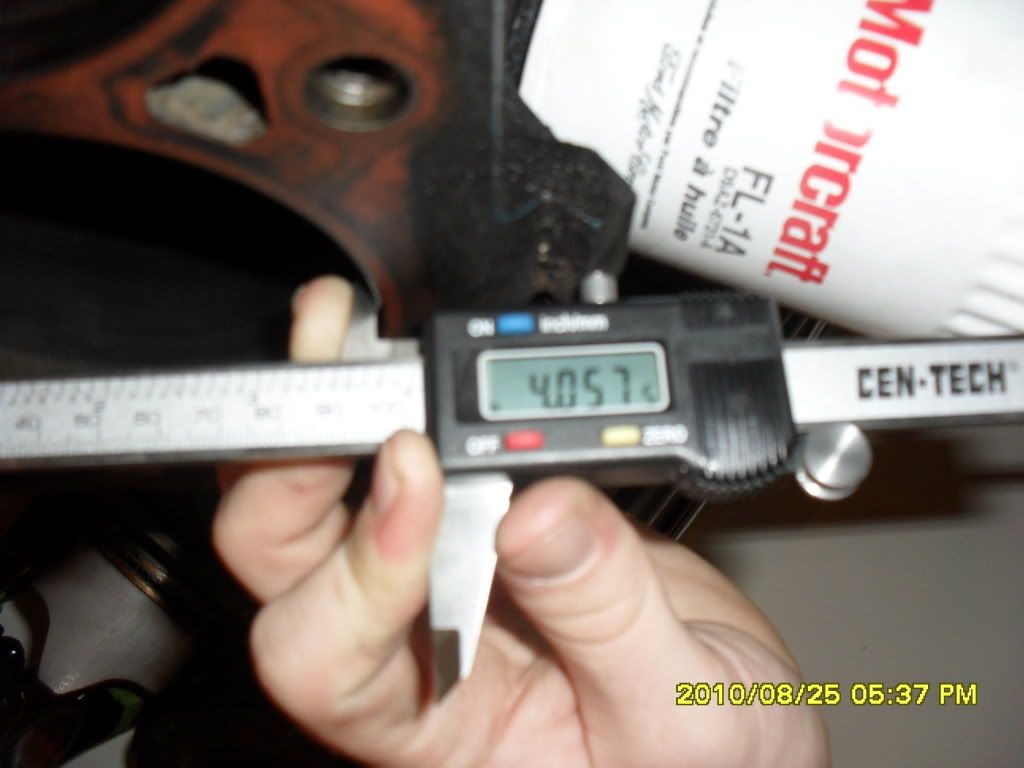

4.060 = no go on this block....
14,464
384
this sucks.... look at the pic...
all the cylinders are at 4.060. the pic shows. 4.057 but this is the only one that didnt hit 4.060... not sure why.....
the block is no good to use... it needs an overbore cause the rust.. so i aint gonna use this block...

No, how bad is the rust? You may be able to do a raunchy hone-job and get away with it.....as for the 4.57......measure futher into the cylinder wall....forget the top of the cylinder....
Why not just bore it out? It's like $30 a cylinder here...not that bad IMO.
Cause its already .060 over ben.
'smiliedoh'...My bad, wasn't even thinking. What's the wall tolerance on a weezy? Could he push .080? If not, I agree with the rest...hone the piss out of it.
uhm, no, .060 over is bout the limit before you start getting really close to getting into the coolant jackets....
Gotcha...I know some engines they say the blocks are good to 80 out...and I've heard of a rare few good to .120 out...but I know most stick to .060. My ignorance for SB's is showing again.

i know of SBC's going .100 over,
now as far as fords go, im worried bout going .060 over cause possible over heating issues.

Or pop a head off and and check the stamping on the piston. Out of curiousity, did you not notice a .060 on the face of the pistons as you were pulling them out?
