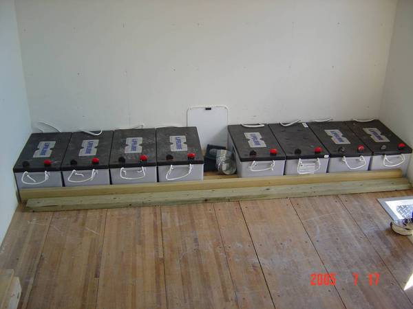

Inverter batteries placed for figuring out shelf design.

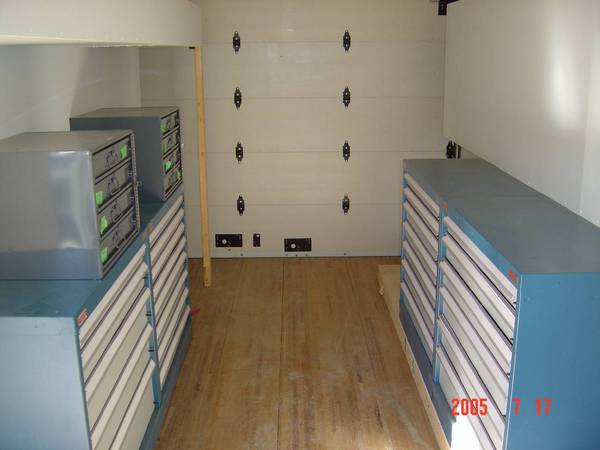

After the cabinets were installed....the sub-floor on the right has a 4'' duct run through it with 4 3'' take offs for the heating system.

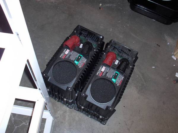

The 2 Outback Power VFX2812 2800VA inverters...they are wired in parallel for 5600VA of continuous power at 120V.

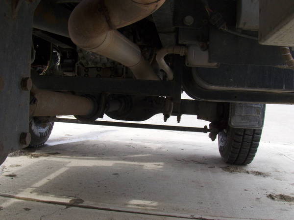

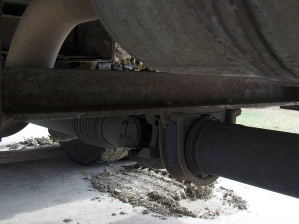

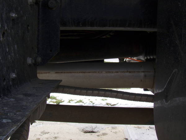

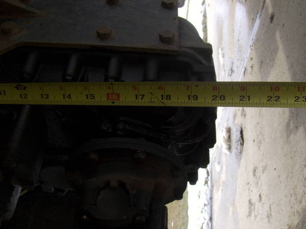

Kind of a crappy picture but the main driveshaft to the t-case and the lower one to the front axle...exhaust pipe in the middle.

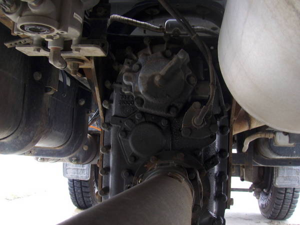

Transfer case.

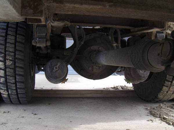

Rear hanger bearing support.
Rear axle view...piece of wood anchored to driveway so I don't hit the house.
Front hanger bearing support.
Rear drive out of t-case
