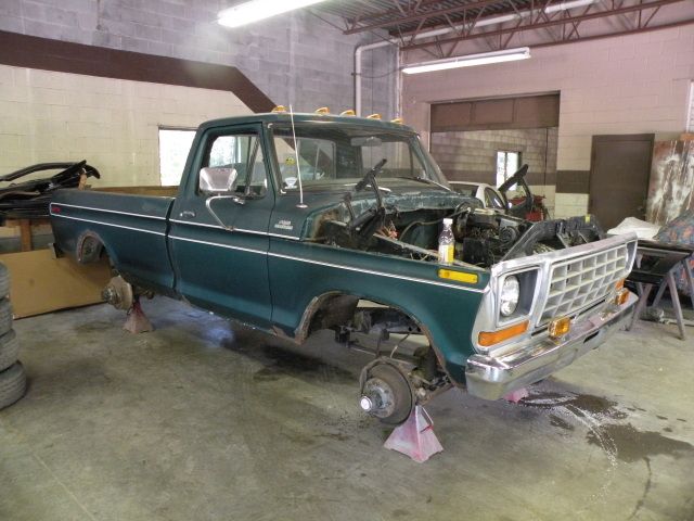

I ended up using this stuff called "Zero Rust". Not really sure if I like it all that much..but i got it for free and need to get my truck done before I move. So it'll work for now. And I gotta update..I finally got the front part of the frame painted and got the engine back in..getting closer now!:beer:
