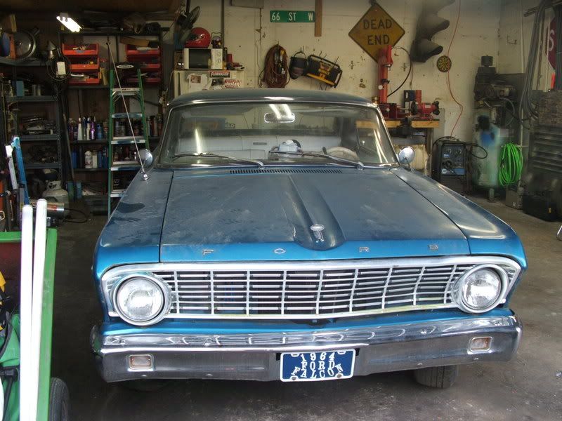

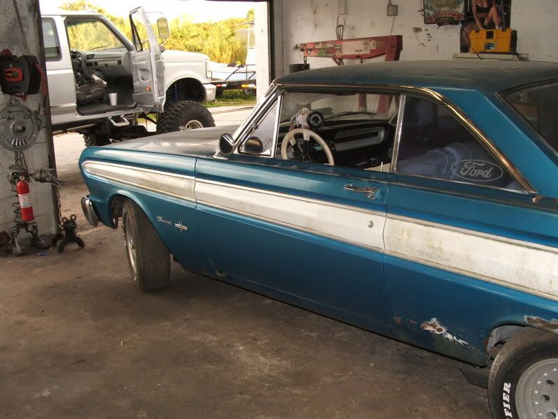

Gonna start freshening up my Dads 64 Falcon Sprint with him. We brought it up to my shop today. It has the 260 V8 and the 2 speed slip-omatic. It was his daily driver for years, but he parked it about 5 years ago, wanting to start working on it.
I said freshening up, because we really can't call it a restoration. Plans are to strip it down, weld in new sheet metal as needed
teardrop bubble hood
New interior and wiring
swap the 8 inch rear for a nine inch
swap the slip-omatic for a c-6
351 windsor bored and stroked to 420
mustang II front end
4 wheel discs
And-
To quote Dad- "A damn defroster that works!!!" :D

I will, but the progress will probably be slow. It's gonna take a bunch of money to get it how he wants it. He's going to get what he can here and there.
Brian_B
blank
I have the same problem. $$$$$$
Well...that and no shop and no free labor. LOL
Looks good, cant wait to see the progress on it.
I tell ya what... makes me a little sad. Andy and I have a friend with a 1962(ish) Falcon just waiting to be restored. It was a high school project his dad was ready to fully back financially and he got lazy and it's now sitting in a field.
This car looks great as it is. I'm excited to watch this unfold.

nice, looks like a fun project
I didn't know you could go all the way to 420 with a 351w?
(needs a 460!)
Yup. A 351w will go a little past 420. A 460 would require way too much front end modification to fit it, and why go the extra weight.
