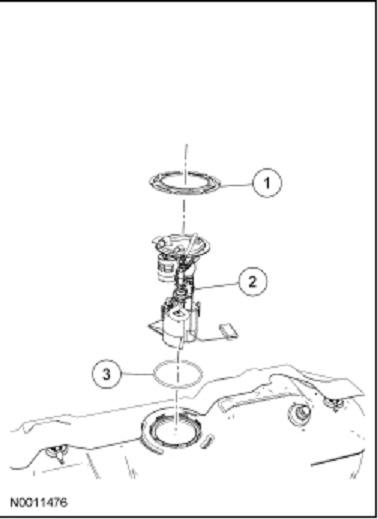

So I have the tank dropped and I am trying with no luck to get the insides removed. I can't seem to find any info in any ford form.. Is there a sticky I am missing? Read this was an easy job just time consuming...help
Found older truck instructions and worked for me as far as getting it out...still any help on this would be great. Can't believe there isnt a sticky about this. Seems like DIY maintenance for sure.

I'm assuming you have a plastic tank
Blacksnapon thank you..... My fuel pressure problem turned out to be both screens in the tank were loaded with crud. I think when we had hurricane sandy I got some debris from my buddy's gas can that I borrowed....runs great now....quick questions
