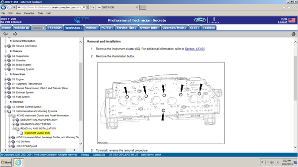

The lights behind my Tach and speedometer are out. Not all of them just the far right and the far left. Inner ones still light up. Anyone have any pictures and/or info on how to go about changing these? Thank you in advancesmilieFordlogo

I don't have any pics, but ive had my gauge assembly out before its not too bad.
First thing you should do is set parking brake
Move tilt wheel into lowest position
Pop off bezel and detach wires for all the switches n stuff. Headlights 4x4 pedals etc.
Take bezel out.
Remove screws and loosen gauges. Detach gear indicator clip (its a little tough but take your time and don't break it)
Then the gauges should pull forward easily and you cam unhook wires.
Im not sure about bulb replacement but thats how u get back that far.
This is all off a distant memory so i hope i didnt steer you wrong.

Removal and Installation
NOTE: Prior to removal of the instrument cluster (IC), it is necessary to upload the instrument cluster (IC) configuration information to the scan tool.
Depower the supplemental restraint system (SRS).
Remove the instrument cluster (IC) finish panel..
Lower the steering wheel tilt adjustment to the lowest position.
Remove the 4 screws and position the instrument cluster (IC) away from the instrument panel.
Disconnect the electrical connectors.
If equipped with column shift, push in the 2 clips and disconnect the transmission range indicator.
To install, reverse the removal procedure.
Download the instrument cluster (IC) configuration information from the scan tool to the new instrument cluster (IC).
