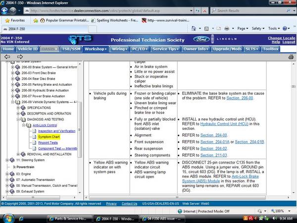

Little complicated, but here goes
Check suspect sensor electrical connector.
NOTE: Use the 88 Digital Multimeter with the maximum resistance hold feature enabled for this test.
Monitor the resistance between the suspect wheel speed sensor terminals while wiggling the electrical connector:
Sensor Resistance
Front 4,000 ohms
Rear 3,500 ohms
If the resistance is above specifications, install a new wheel speed sensor.
NOTE: Use the 88 Digital Multimeter with the minimum resistance hold feature enabled for this test.
Sensor Resistance
Front 2000 ohms
Rear 800 ohms
If the resistance is below specifications, install a new wheel speed sensor.
Monitor the resistance between the wheel speed sensor terminal and ground on the highest resistance scale of the meter while wiggling the electrical connector.
If the meter shows anything other than an open circuit, install a new wheel speed sensor.
