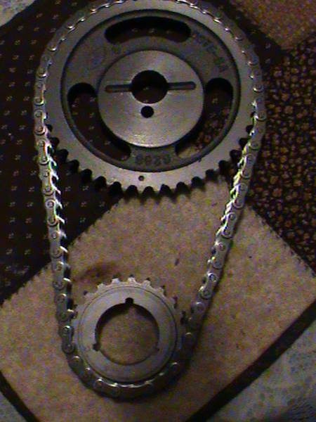

Doug for straight up timing you will line up the gears as shown below...

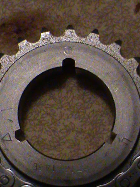

Now the crank gear has the 3 notches as you indicated..you will use the notch that has the dot..line this dot up with the cam gear in the position ive shown...that is straight up timing..

Yes Doug..it is as easy as just changing the timing gears...from a retarded setting to straight setting up really wakes these engines up...It all can be done in a good days work...smilieFordlogo
