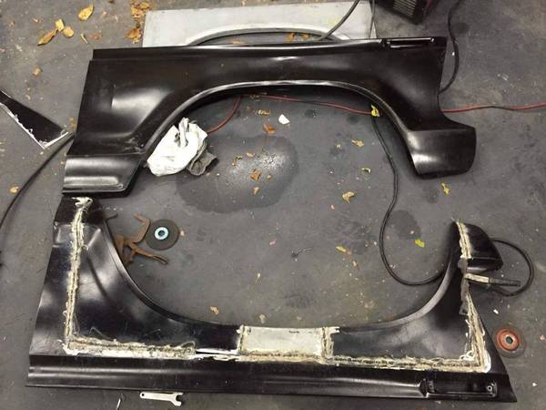

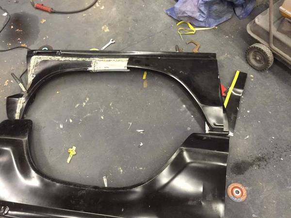

Didn't want to drop $600 on glass fenders, not a real fan of cut outs...soooo decided to play around a bit. Wheel well lifted about 1" and stretched about 1.5" on each end...

I love it. How much. :-D

Depends if you have cores and if they're usable. If everything needs to be provided, a little cheaper than glass. If you have everything and just have to pay labor...you could get 2-3 sets for the price of glass. That's ready to paint. Still in the prototype phase...harder numbers will be available when completed.

Keep me updated. ;-)

I have always been a sawzall afficionado, though... ;-)

That looks great Ben ..... panel work is slow going to keep the heat down :)
