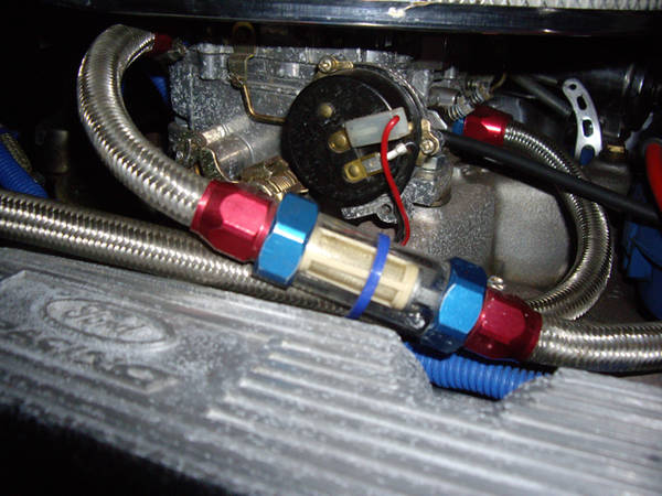

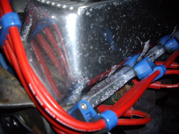

My rig, since it's rebuild only has 11k miles on it, with about 5k put on since this past Spring. I took it out yesterday and noticed some white spray on both of the valve covers and a little under the air cleaner and wondered if you guys had any thoughts. I've driven this thing through the rain and through puddles and such an had never had this sort of stuff show up where it is now or anywhere else in the engine bay for that matter; just this last 60 mile or so trip. This is the first time I've seen this stuff in my engine bay. When I touch it or try to scrape it with my finger nails, it almost feels like it's eating away at the aluminum covers and has to be scraped off and then repolished.
I don't smell gas when I rub my fingers on it, but that doesn't mean anything....could just be dry.
Could some fuel be spraying from my carb?
What should I check if anything? Thanks for any help.
Definitely some sorta corrosion. I've seen that come from an antifreeze leak that gets sprayed across the engine bay when driving. I had one in Red that was a pin hole in the radiator that didn't leak until the rpm's got high and then was sprayed across the engine bay by the fan. I've also seen that kinda corrosion come from driving in a slat water environment. I'm not necessarily saying that's what it is, but that's what I've seen with witness marks like that before.

If that corrosion wasn't on the carb too, I'd say you just need a polish. But it is on the carb, and seems to have covered the engine bay pretty well and seems to decrease the further back you get. However, your alt seems to be just fine, so I'd think maybe a pin hole/fray in one of your hoses...getting blown around by the fan.

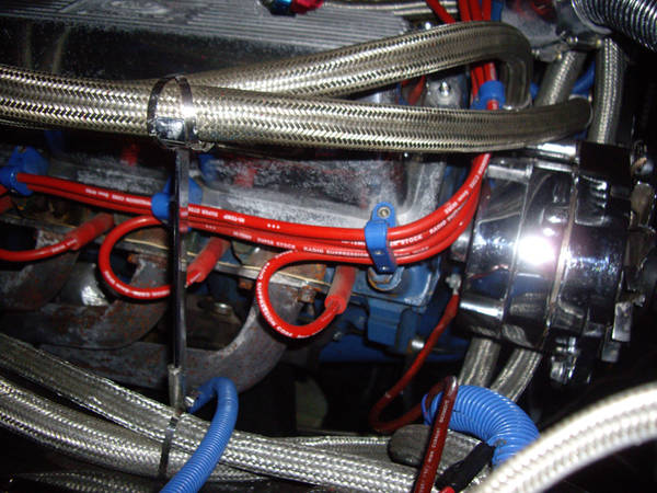

It is much heavier in the front. The alternator did have some spray on it, however since it was chrome (valve covers are aluminum), it just wiped off clean. The stuff on the covers are almost like rust...have to kinda scrape it off. That's what worried me.
I don't see it on anything but the aluminum. The chrome dosn't show it. S/S brades on the hosees or rubber on the plug wires.
Don't know why it didn't show up on the other stuff....maybe the rubber and braided hose material didn't allow it to discolor or stick. Some kind of chemical reaction to the aluminum?

The other fluids (tranny and oil) would just cause a mess, wouldn't corrode it any. Gas could leak too, but I haven't seen it corrode like that. If it is in fact a fluid leak, I'd believe it to be an antifreeze leak. It could be coming from the radiator itself, maybe the upper hose, maybe a heater core hose or maybe from the thermostat housing. Doesn't necessarily mean anything broken, split, frayed, etc...maybe something just needs to be torqued down.
That said, I think I'm gonna switch gears on you and wipe down and clean/polish the affected areas, try to avoid any puddles and see if it comes back. If it does, then you have a leak somewhere in the engine bay IMO.

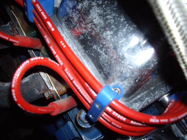

Sounds like a plan.....by the way, these won't just wipe down....I almost have to scrub with a brillo pad or wire brush on the aluminum to remove and use a dremel tool and some mibro to polish.
These corrosion spots (not sure what to call them) just showed up this past week. Had never been there before.

Before you go and ruin the finish on your VC's...try some NeverDull or Mother's Aluminum polish...and I've even heard aluminum foil and coca-cola work too.
