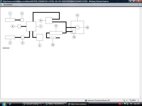

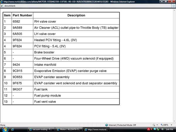

Could somebody PLEASE help. I need the vacuum line routing on the 09-10 . 4.6-3 Eng. On an F150 other than the spur going to the power brake I need to tap it for instrumation. Thanks for Looking. :wavey: :wavey:
