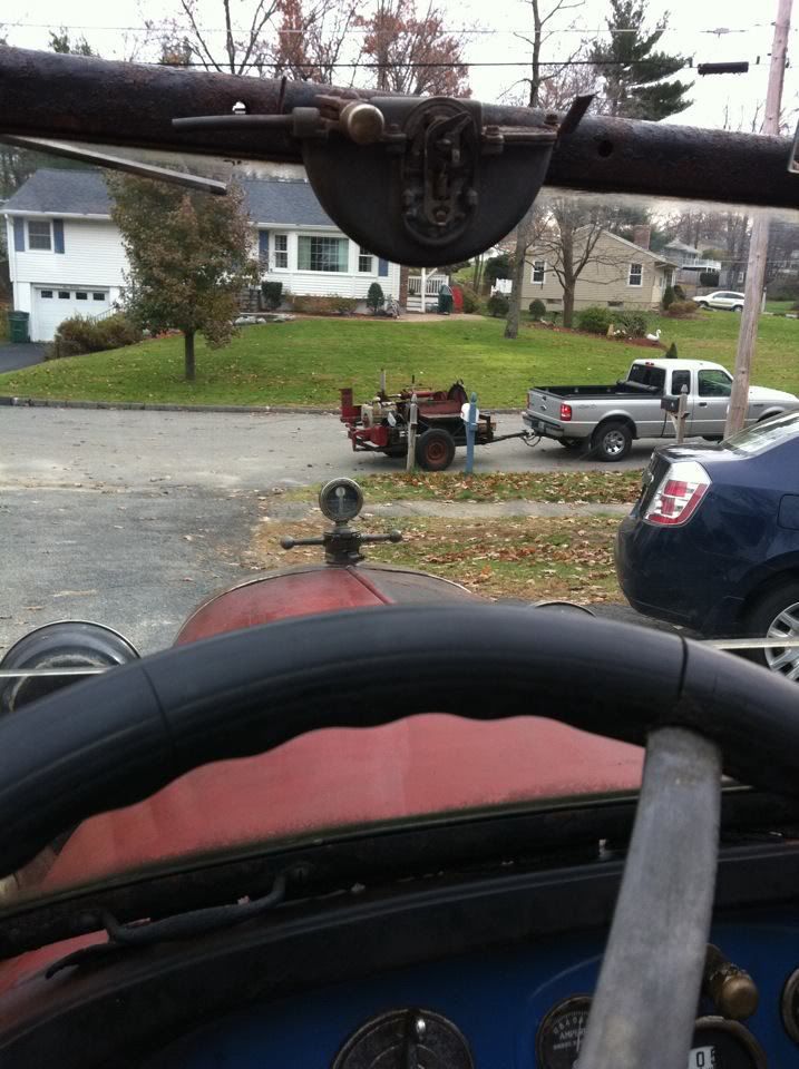

No pics of the heaviest trailer (just a hair over 3,000 lbs), but this was the most interesting:
Probably somewhere around 2800 lbs (??), but with maybe 40 lbs tongue weight.
