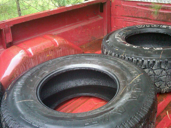

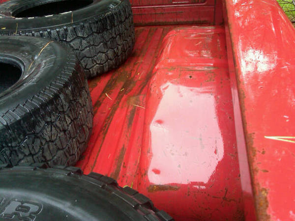

Here's some pics of the bed....I was all dressed up when I took this pics this morning and didn't want to climb in and move the tires...these are my new tires by the way and now I can get rid of those stupid thornbirds!
Hard to tell with this pic, but basically, the back of the bed that is up against the cab is basically what the entire bed looks like. It's in decent shape:

That's not bad at all!
A would just hit that with a course scotch brite pad and throw some primer and paint on it.
Either paint or the roll in bed liner is all that needs. I don't know if I would use POR15 for that application as it would have to be painted over either way. Due to the fact it breaks down in UV light.
A good coat of paint will block a the moisture reaching the bed surface so I feel POR15 is unnecessary for this.
Dang Ken...that's not rust, that's barely even character. Like Randy said, I'd scuff it up...then lay down some paint/bed liner
