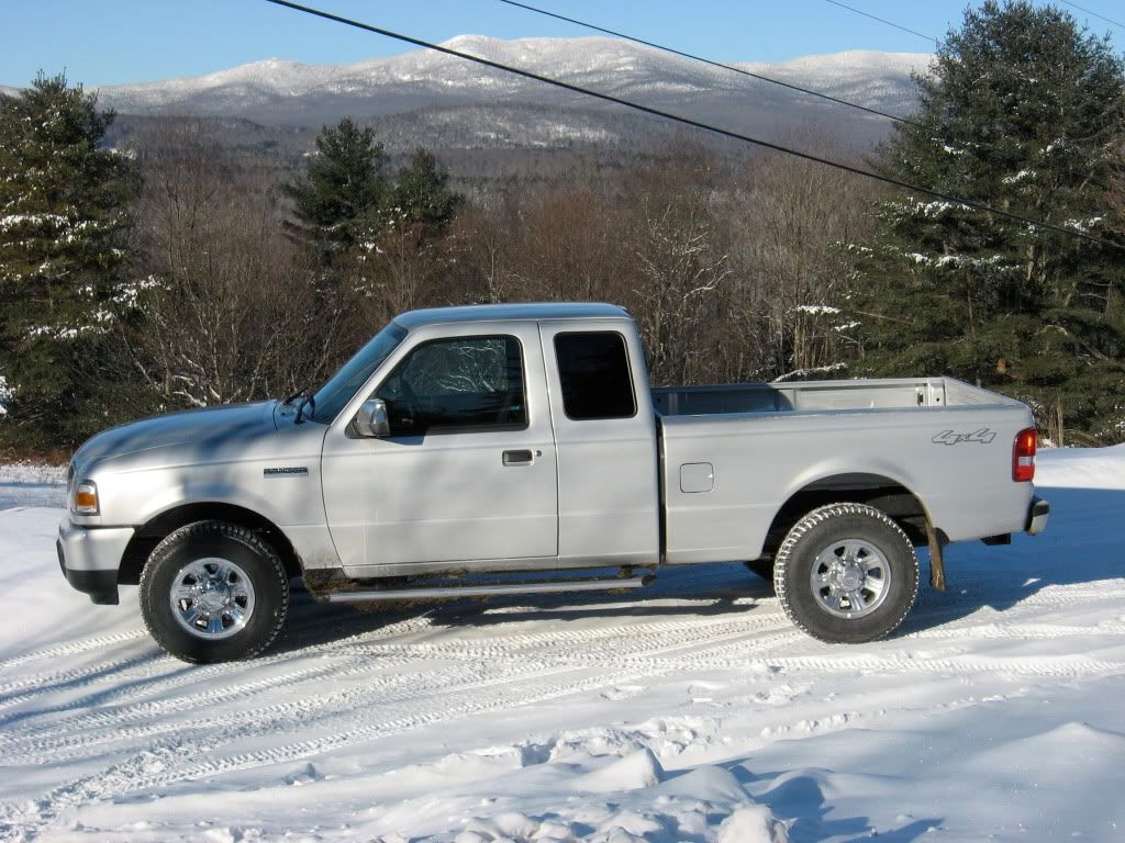

on this truck:
Tire size will be 235/75-15 (what's on it in the pics), tires will be highway biased all-seasons (stockers, 'til they wear out, then replaced with a better version of same), and I'll probably just move the chrome Ford center caps over, rather than spend the extra cash for the Cragar center caps and chromed acorn lug nuts.
Thoughts? I'm slightly hesitant about the black rims, but I need to run steelies (to clear the brakes without moving to a 16" rim), so most of my "top choice" wheels are out of the question, even if I could afford them...and I'm leaning toward black over chrome or grey steelies.
*Guess I should mention the rest of the chrome on the truck- step bars are coming off, bumpers are painted silver. Grille and mirrors are chromed, but that's it other than the wheels.
