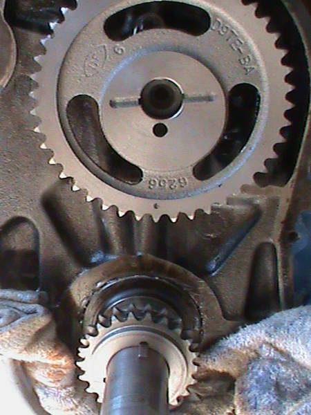

Just purchased truck previous owner replaced timing chain and gears not sure if it was done right -- how do the marks line up -- any help would be helpful. smilieFordlogo

Welcome to FTF Kenodom...Your cam gear should be in the 6 oclock position..crank gear at high noon...
