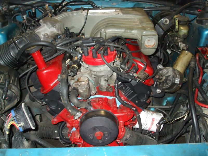

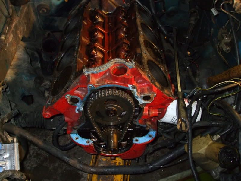

The Mustang needs more power so...........
http://i77.photobucket.com/albums/j46/1954ford/camchange002.jpg
and
http://i77.photobucket.com/albums/j46/1954ford/camchange013.jpg
http://i77.photobucket.com/albums/j46/1954ford/camchange001.jpg
http://i77.photobucket.com/albums/j46/1954ford/camchange010.jpg
half way there.My son graduates high school tommorow so I will probably not get back to it until Monday or Tuesday.

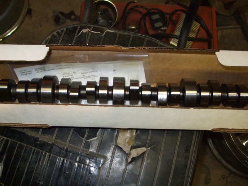

Will your headers work with the P heads? And what cam is that?
I bolted up one of the headers and I see what everyone is talking about.It,s looks like a problem getting a socket on the plug.I have some old sockets and before I bolt the heads on I am going to see if I can,t just grind a socket down to get the plug out or cut a slit in a socket.I think I can come up with something.I,ll take a picture of it later if you like.
Trick Flow stage one.
5.0
FTF'er
1,319
In the Middle
Nah, thanks, but I don't need a pic. I was making sure you checked the plug angle before you actually went through the trouble of bolting the heads down. The P heads work for some people and not for others. You may have to use wires with 90* boots if you have straight boots now.

I just got back from a quick test drive down the road.Just timing set by ear,no hood on.
It pulls a lot better.Before it would fall off at 4k.No more it pulls and keeps pulling.
I,m letting it cool down.The passenger side header is leaking.I need to fix that,set the timing,put the hood on,and evac and charge the ac.
