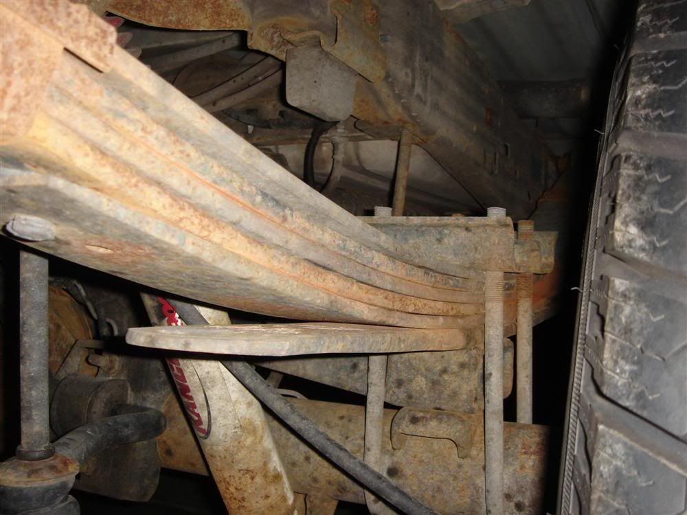

Whoa wait a minute... You mean to tell me your springs are mounted UNDER your axle?! It is much more common, ESPECIALLY on a full size 4wd truck like yours, for the springs to be mounted on top. Have a look at mine, stock except for a couple add-a-leaf's:
If you're springs are really mounted under the axles then BY ALL MEANS switch them to the top.

Yeah I'll eventually undercoat the whole thing with POR-15 or Eastwoods... But it'll be the job from hell so I keep putting it off :headbang:
That was my undercarriage RIGHT after I had gotten hit with chemicals in the snow, so it looks a lot worse in those pics than it does now. What you see in those pics, the rust is nice and fresh and bright. Now it's dulled out and is starting to look more like aged metal ;)
