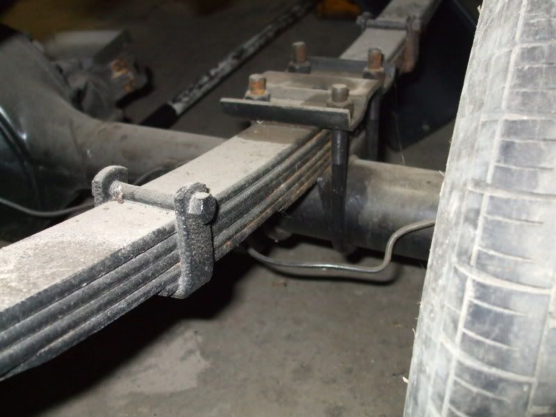

The springs go on top in the stock setup.
Here is the rear of mine with the wheel off:

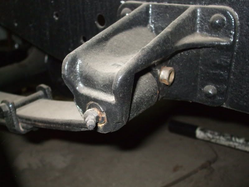

ok i must be dumb but i cant figure out how to get this front mount of the leaf spring off here is a pic of what im talking about.
You see that "pin" sticking out of there? You have to get it out of the way first. It is wedged into a slot in the "bolt" that holds the spring in there.
Then (I think) you have to drive the "bolt" out from inside the frame.

alright i got that threaded pin out, didnt even know it could come out haha, now it seems like there is a pin or something through the whole in the leaf spring but does it need to be hammered out if so does it matter which way? thanks

Thanks redlightning. I did not have a picture of the pin anywhere.
Yes...you drive them out from the back (inside the frame) with a drift pin.
