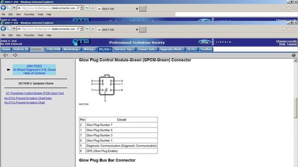

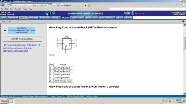

I take it you are thinking glow plug module. Testing procedure?
