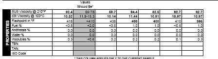

Report is in @ 132,390 miles
Attached is a copy of my Blackstone oil analysis report (broke it down into 3 images so it is easier to read each section).
This sample had 4,814 miles on it and my truck has a total of 132,390 on the motor.
All is well and all values on the report look good and consistent with prior reports.
What was different for this analysis is the following:
1) Running same oil and type, but is new CJ4 spec'd oil rather than the old CI4+ (Rotella-Syn 5W-40).
2) The full-flow oil filter was hand-built Racor test filter they sent me to try. It had a different media and each pleat was held in place to allow uniform spacing all the way around for even oil filtration and flow.
The miles on the oil were consistent with prior samples sent in and all samples were taken after driving for 20 minutes or more on the highway, so the oil was hot and very "fluid".
It appears that the "test filter" that Racor sent me performed no different than a stock Racor/OEM filter they are currently selling. The values for insoluables was slighly higher, but only by 2 tenths, so not very much. Maybe the new CJ4 spec'd oil kept the insoluables suspended much better and therefore not able for the filter to filter it out???
Bottom line, my motor is running well at 132,390 miles!!!!!
