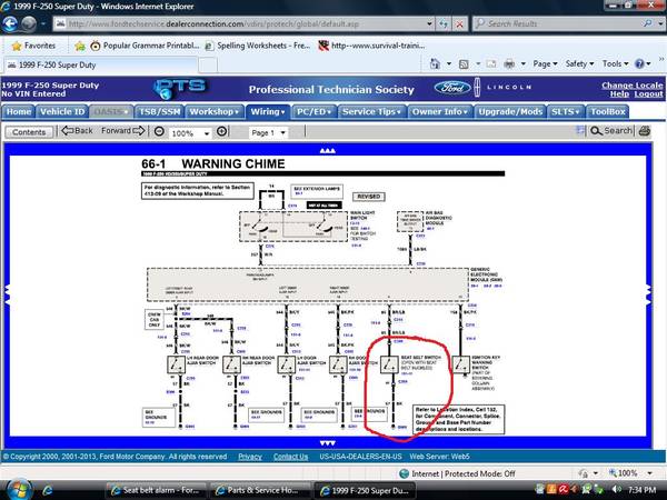

You need to check continuity at the electrical plug on the seat belt on the harness side. There should not be any continuity to ground.
