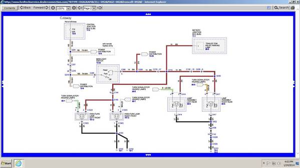

Blacksnapno. Im sorry but the pic out of the book you put on here i can never see right there to small. Can you make them bigger??

Thank you for the info, and input. After reviewing the diagram, I am leaning towards the switch being bad. Or possibly the wire from the fuse box to the switch. It seems to me that some of the lights would still work if it was in the wiring after the switch. When I get the switch out, i will check the wire powering it. If that shows juice, then i will replace the switch.
Thanks for the info, and input. I'm leaning towards the cause being the wire from the fuse box to the switch. Or the switch itself. I think if it was after the switch some of the lights would work.
