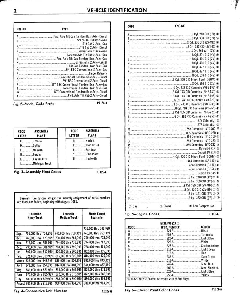

Welcome to FTF
F25 = F250 2WD
Y = 352 2V.
K = Kansas City MO Assembly Plant.
860414 = 1966, assembled May 1966.
ALL 1965/76 FE engines look identical, and on sale day, 352/360's magically become 390's!
The only way to ID a 390 is by measuring its stroke, which is 3.78 inches. 352/360's have a 3.50" stroke.
360/390 introduced in 1968 F100/350, used thru 1976, so if it does have a 390, the engine was swapped.

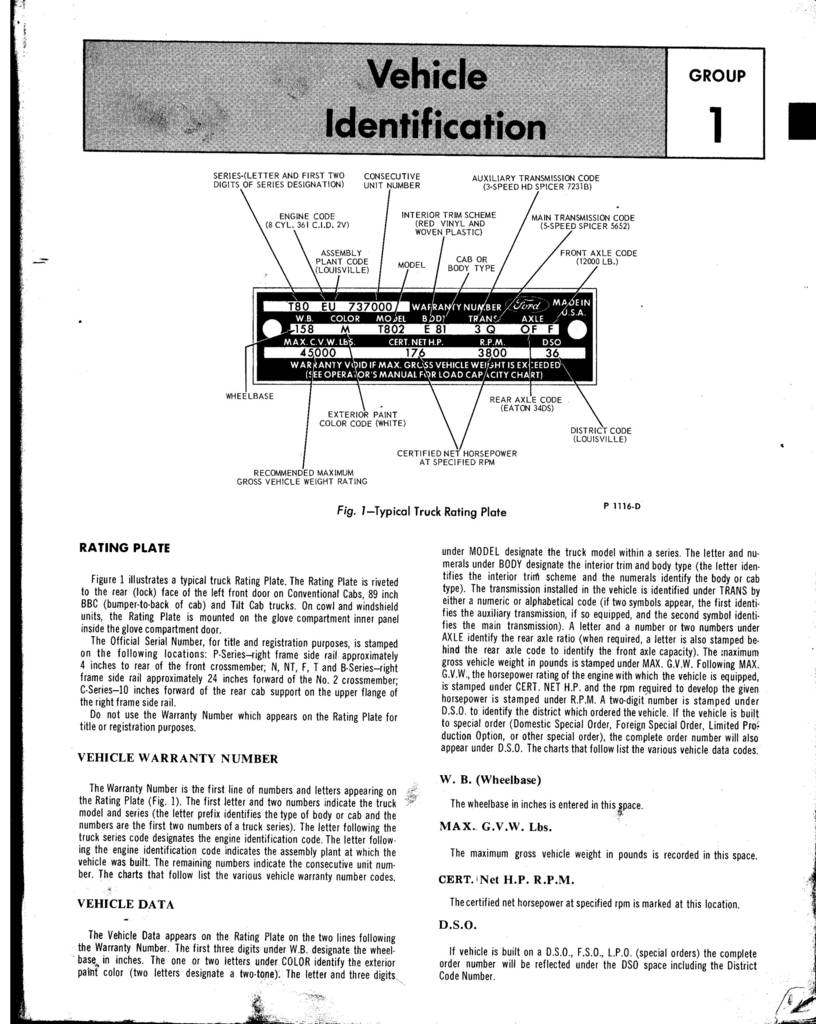

There's no such thing as a Y AXLE code, no such thing as a 2 4 ENGINE/TRANS code

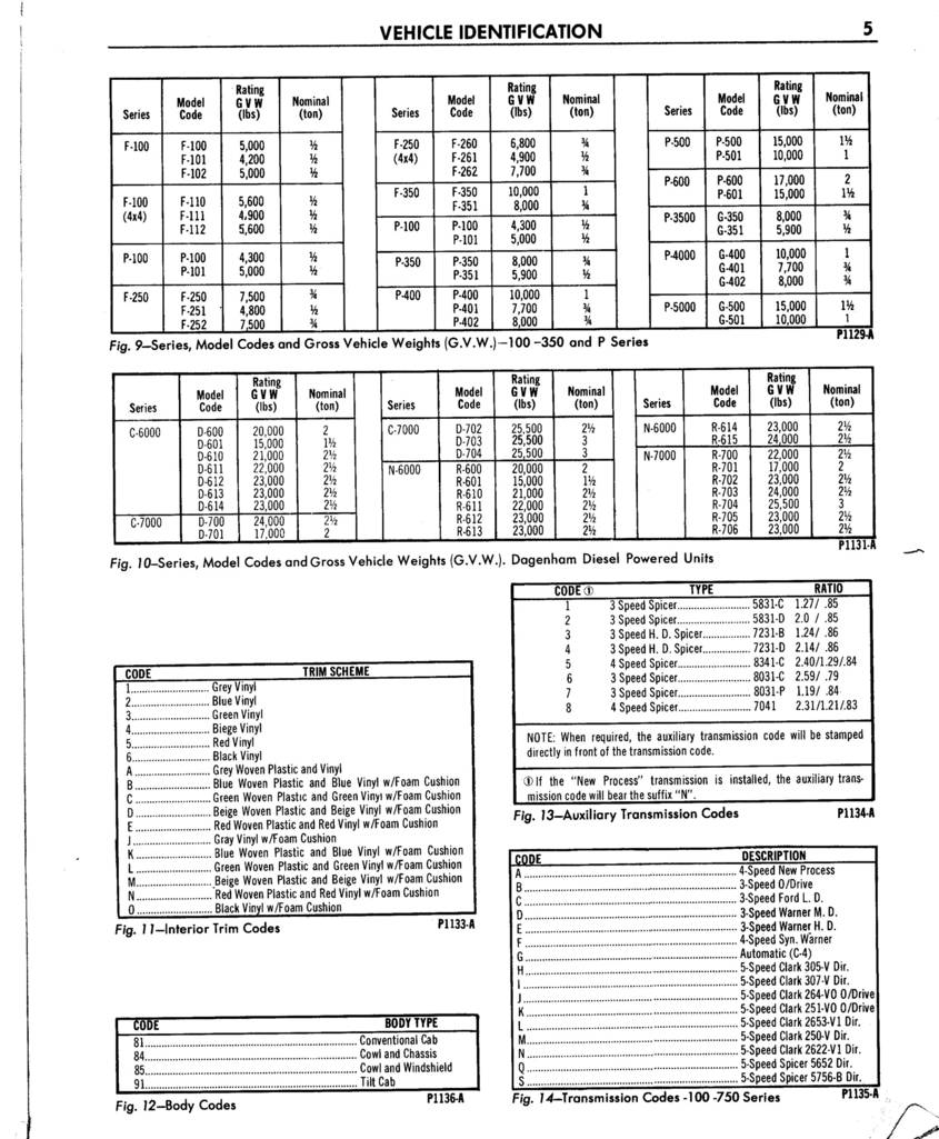

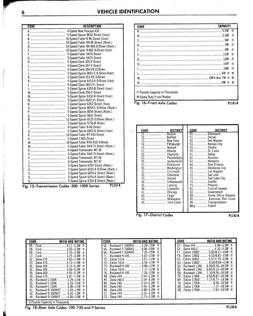

The AXLE code is stamped on the 2nd line-far right of the Warranty Plate, it's probably 24 = Dana 60 Rear Axle / 4.10-1 / No Limited Slip / 5,200 lbs. Rear Axle Capacity.
TRANS code stamped on the Warranty Plate, will be A for New Process 435 4 speed, C for 3 speed manual, F for Warner T-18 4 speed, G for A/T.
1965/67 F100/350 352's came with MX Cruise-O-Matic, which has 14 trans pan bolt holes.
C6 introduced in 1968, has 17 trans pan holes.
