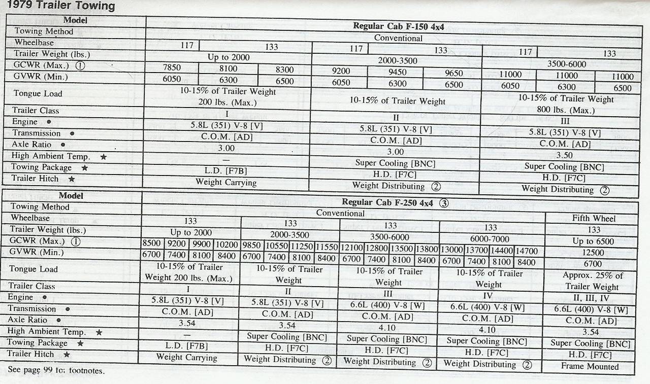

Weight is truck GVW...not what it can tow.
Just an FYI...your axles weights combined will almost always exceed the total GVW of the truck...eg, my 350 has a rear axle rating of 7000# and a front of 5600#...so you would think 12600#..not so, it is rated ate 11400#.
The only way I know how to properly figure out what your truck can tow is to consult the owners manual.
Looking in my 79 owners manual for your model and wheelbase, could range up to 7000# trailer weight depending on engine, gearing and cooling capacity.
