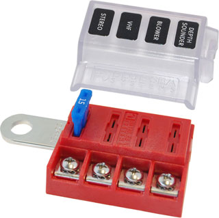

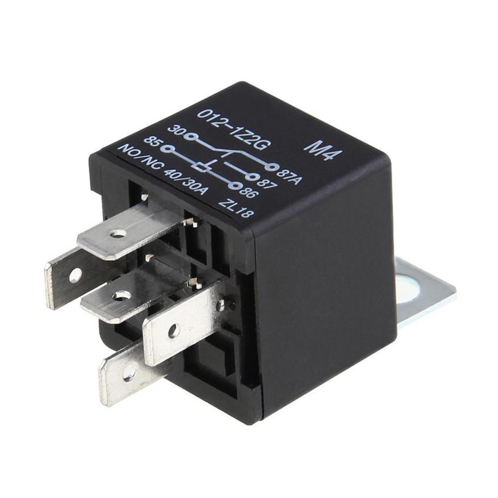

^^ what i would do is use a feed from the acc and run a 12v switching relay onto a small aftermarket fuse box , then you will have a good power source to run your radio and whatever else you may like with out fear of draining the battery.

With very little effort you could wire the deck using a plain jane, common 12V automotive relay functioning as a latch and as such, the deck works with the key in run, acc, AND now......like vehicles have been doing for awhile, the deck stays powered up until one of the doors is opened (breaks the latch). You won't have a timed off for the deck like the newer rides do, however, I have yet to hear of anyone draining a battery from an oversight. Very simple mod to implement and very nice when for example, experiencing an extended wait in a line (drive in window for example) as turning off the engine doesn't interrupt the music. Something to think about here in Y2016. :)
