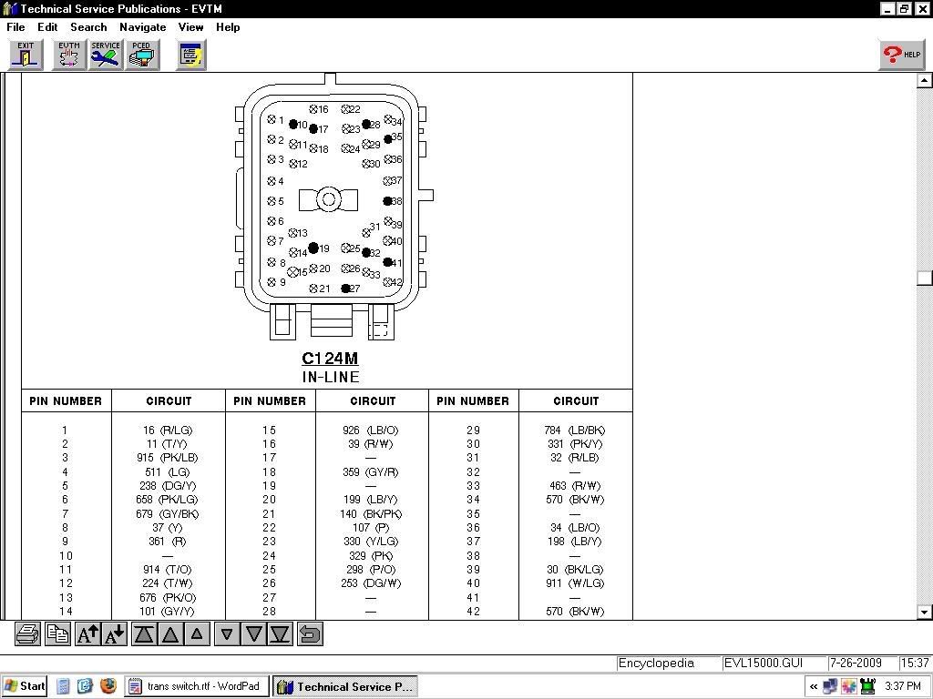

Suppose I have a wire in a connector that has been cut and I need to know what it does. In this case it is pin #33 in the following illustration.
It claims that this is circuit 463. Is there anywhere on the CD that I can go to find a certain circuit and what it does?

Without knowing specifically which components are effected (Ford evtms list the component, then the circuit that powers it), you'll have to go to the wiring section (components) then one by one look through each page looking for circuit 463.

Sounds like fun. I'm guessing it may have something to do with the A/C, and I looked a little bit at the A/C section... but I was hoping for something more simple. Without ever being trained in using the software it makes it a little tricky to navigate at times, but I'm doing pretty good now. Thanks for the reply!
