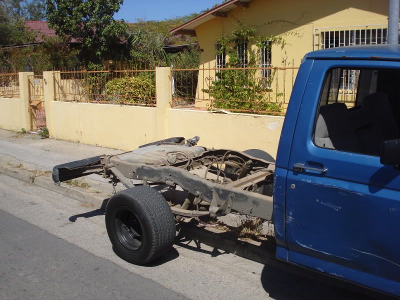

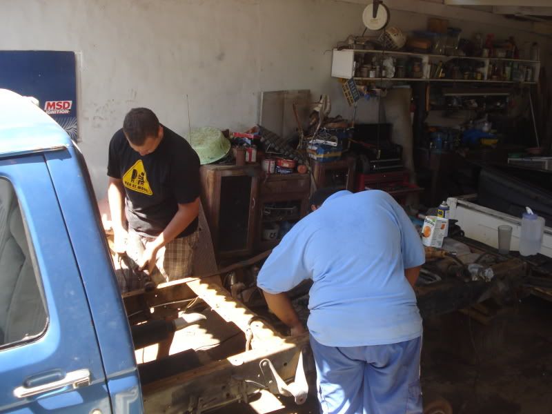

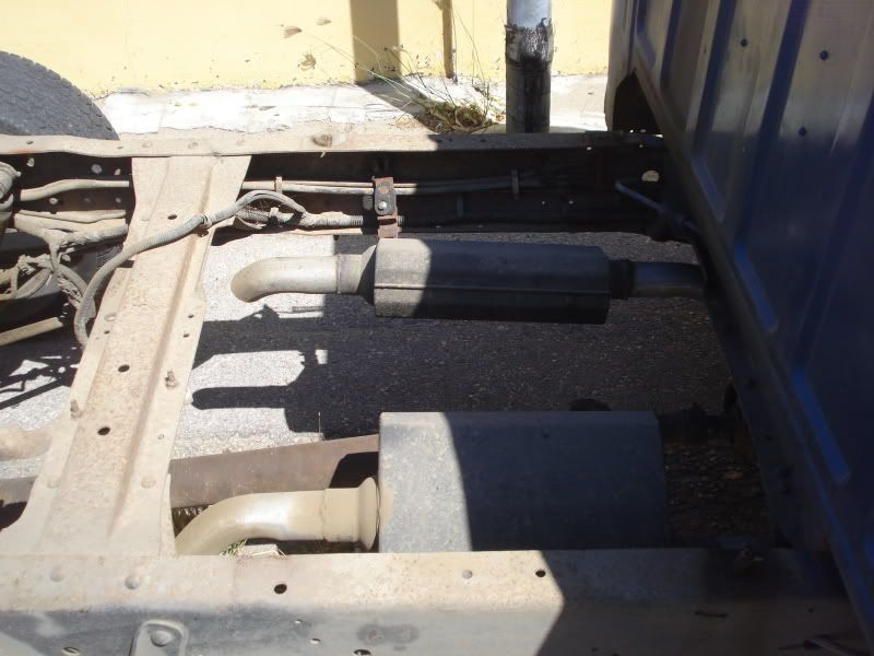

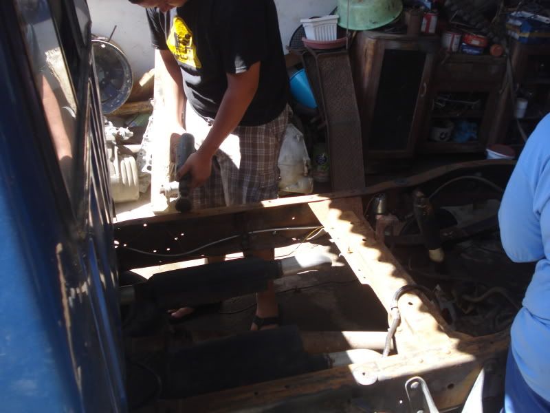

removed the old bed today.. and did the suspension work
installed the DJM drop brackets
then i tried removing spring nr 2 and 4 from the leaf pack to get a little more lower.. but its too loose and too much and as soon as i step in the bed it hits the bumpstops.. to level it out i have to mess with the front end.. wich i dont wanna
soo tomorrow im going to install leaf nr 2 back.. and hopefully it will level it back out..
