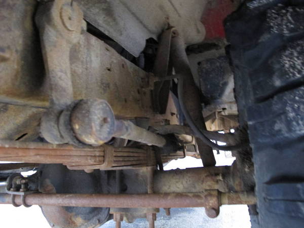

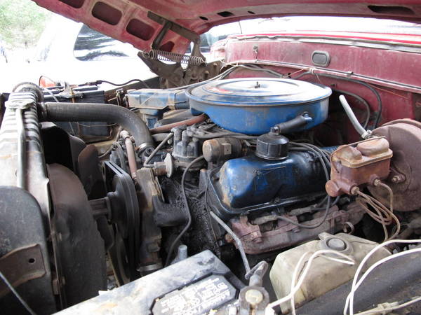

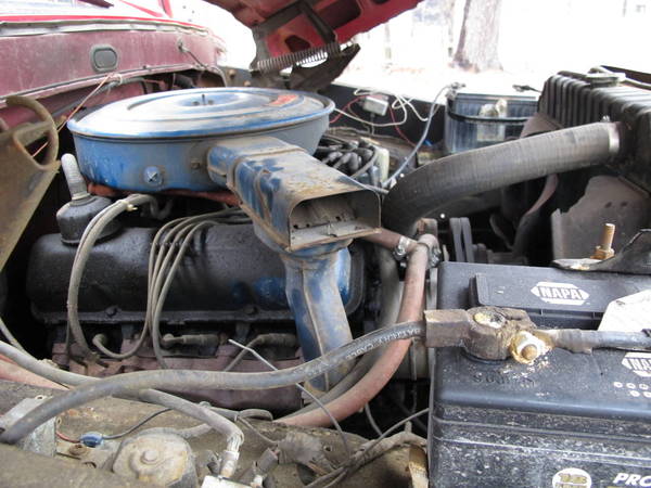

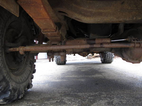

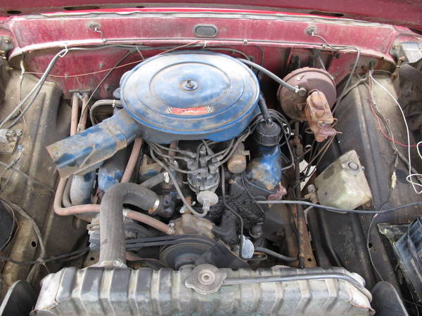

Another thing that's kinda boggling me is why all that oil seapage just below the valve covers...is that something that is happening continually or over time, cause I've been through a 1/2 dozen fill ups of fuel and this thing does not burn 1 drop of oil! Pretty wild. I also parked it on my driveway for a few weeks to see if any leaks, and not one darn leak....awesome! axles are dry, but show a little oil on them but it looks like it's been there a while in the pictures below. And I'm not sure why the little wet spot on the shocks.

As for the oil seepage...have you check the oil levels? If no considerable level drop, probably just time for some new gaskets. Have you tried just simply re-torquing the bolts? It wouldn't be uncommon for them to be finger tight.

Good point Ben.....when I first bought the bump, someone on here mentioned that and I went outside and you could turn the bolts with your fingers, exactly as you said......I just tightened them and they're all set. Probably just old oil seepage from the loose bolts.
I have checked the oil level at each fill up as I don't know the truck as well yet and want to make sure I get a feel for how it needs to be driven and maintained....so far, not even the slightest change....this motor is awesome...need to get the timing checked as suggested before and a few other things. I'll give it a good major tune up before it starts snowing.

I'd pressure wash all that you possibly can, and what you think needs just regular garden hose, do that. I would also power wash the underneath and undercoat the whole underneath of the truck. I usually do that a couple times a year, prevents rust

Yup, one of the things on my "Bump to do" list this summer. I actually bought all the material to convert and encapsulate the frame and axles from Eastwoods.....looking forward to doing this to preserve the frame long term as it will be my winter driver.

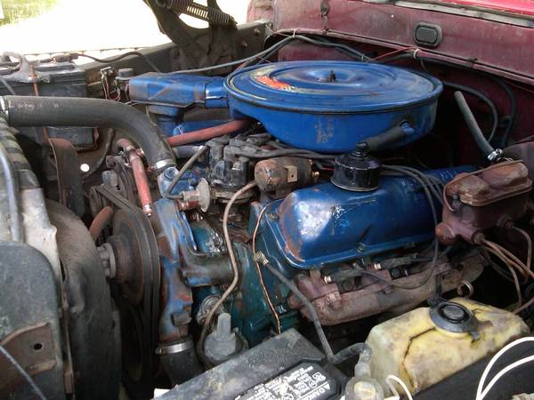

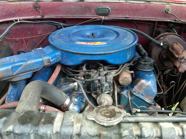

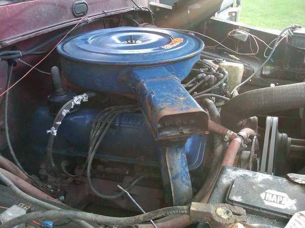

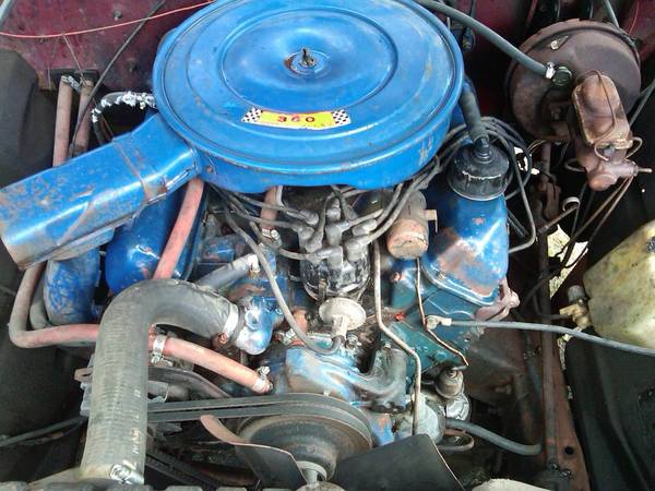

Pressure washed yesterday!
Before:
After
Before:
After
Before:
After
I'm real happy with how everything came out. I got my pressure washer from HF for father's day and did what you fellas suggested....I covered the distributor, battery's, and there were two electrical boxes on each side of the engine bay (not sure what these were, but I wrapped those up in plastic also), plus an electrical switch on the back end of the engine bay wall (I plan on having this removed also - it was used to shut off power to all the lights and such when it was with the FD). I sprayed an entire can of degreaser every where I could and let it soak for a few hours, then got the washer and went to town. Pictures don't do it justice...it looks real good. I want to take the valve covers and air cleaner off now and sand it and paint it blue.
After I washed everything, I pulled the plastic off and jump in and she started right up....made me happy. Thanks again for all the tips. Now on to the next thing to do with the bump.

That cleaned up right nice.
Thanks, I was pleasantly surprised!
Good job Ken. I did mine at the do it yourself car wash so I wouldn't have to worry about all the krud that came off.
Thanks. This is one thing I didn't think of....lots of crud came off and on the ground....but no biggy.
once you get the big gunk off, try castrol super clean, it takes the rest really nice. Also spray it on rubber (tires, windshield gasket, etc), then pressure wash. You won't believe how black and clean the rubber will be. After, put Armor All tire foam on the tires, it is unbelivable!
